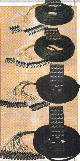

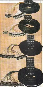

I do it with a snake. You just plug the snake into the preamps and every time you want a certain preamp, you plug into that channel on the snake.
If you have 16 channels of mic preamps, you get a 16 channel stage snake. Plug the male ends into the mic preamps. The other side is a box with female xlrs. Plug your mics into that. You just have to remember what channel on the snake is what preamp.
One of these guys-

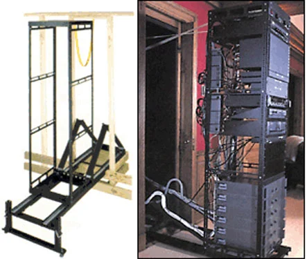

This is a little late to the party, but you might consider this.
