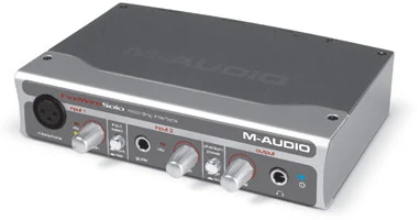

I have a M-audio firewire solo. It has one XLR and one 1/4 inch input on the front, 2 1/4 inch line inputs on back, and a spidf connection for connecting things that have a digital output. Mine was 199 bucks and I am happy with it.

This is mine, notice on the front it has Xlr input (for mics) on the left, 1/4" (for guitar or mic) in the middle, phones at right. It has a button for phantom power, and two knobs to adjust the gain/level, something the Delta44 does not have.
Warning: a card like mine is good for ONE person doing one thing at a time. For recording a band or drums it would be a bad choice.
