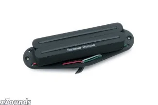

You can get humbuckers that fit in a single spot.
Such as Seymour Duncan Hot Rails.

a true single-coil (like on a stock strat) will never sound as fat and rich as a humbucker. theyll always sound 'twangy' no matter how much overdrive you slap on the amp. reason: the pickup takes its signal from a narrower range of the vibrating string. the bridge pickup is particularly bright as its near the bridge and picking up a high harmonic. humbuckers are basically just 2 singles stacked next to eachother and slightly out of phase so they dont hum. the two poles of a humbucker take its signal from a fatter area of the string, so they create a fatter sound. you can switch a strat to use 2 pickups at once, but theyre so far apart from eachother that you just get the sound of 2 singles operating at once instead of a fat humbucker sound. bottom line: if you want a humbucker sound, get a humbucker. those hotrails mentioned previously sound pretty nice in a strat.
I always had the same problem when I first got my strat. Was convinced ther would be some way to get the kinda distortion out of it but to no avail. So I stuck one of those hot rails in, and it sounded totally sweet. Its still my main guitar and I use for pretty much everything. Suits me fine for my death metal recordings as much as it does for anything else :)
That's what I run on my Strat. Made a huge difference for the better. Awesome mod for what it costs.
