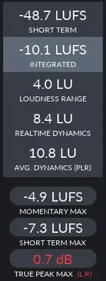

The mix is a little hot. CD quality, maybe, but high for streaming. I might make some minor edits on some plosvies, and just make sure you're not monitoring your mix (for mix/master decisions) at too high a level. I like the sound of it better when I turn it down :). Very nice cover.

Thanks for listening and for the input. I was actually thinking the same thing myself. I assume you’re talking about the latest mix, as I didn’t quite feel the same way about the first one. And strangely I didn’t change any of the mastering settings - just mostly different eqs on instruments in the original mix. But it did seem to make it hotter in the final, which tends to make it a tad harsh imo. I’ll back it off a little in the master.
