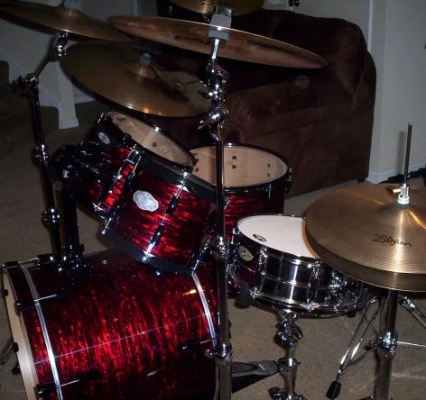

I bought a brand new set of Pearl Vision Series VSX this weekend. Right away I changed the top heads on all of the toms to Evans EC2. Then I took the factory "Pearl ProTone" batter heads and put them on the bottom to reduce ring. I had an easy time of tuning them all except for the 16" floor tom. The new top head stubbornly resisted being tuned. (I have been tuning drums for years and I usually get them in pretty good.)
Even under tension, there seemed to be this slight wrinkle or wave in the head between two lugs. When I turned down the tension rods enough to remove the wave then the head was tuned much too high. When I tried to take up the tension with different lugs the head was badly out of tune. I kept going around and around with tuning problems and I couldn't seem to get it right.
At first I thought I must have accidentally stretched the head somehow. But that is not like me and besides, I had not over-tightened any tension rods prior to the wrinkle showing up.
I removed the head and checked the shell for out-of-round. I couldn't find anything wrong with the shell and the bearing edge was flat. I checked the metal hoop for warpage. Nothing there either.
When I placed the head inside the hoop (off of the drum) it did not fit very well. In fact, it would not seat squarely at all. Instead it wanted to teeter back and forth like something tiny was beneath it. At first I thought that it was the fault of the head. (Remember this is an Evans head and the edge ring is slightly larger than Pearl heads.) But after a closer look inside the hoop I noticed an odd raised ridge or lip in the metal just above the bend. It apparently was left there from machine stamping in the factory. It was preventing the edge ring from fitting all the way down inside the hoop on one side.
I did not want to return the drums to the shop because I know them all too well there. (I'd been going there for years.) I am almost certain that they will just dig through their junk box until they find a hoop that fits half-assed. But I don't want a reject hoop. I want a powder-coated "Pearl" hoop and I want them all to match. So, I decided to beat the bitch into shape.
I whipped out my trusty Dremel tool and carefully ground down the ridge until it felt smooth. [Fast forward twenty minutes…] Now the head fits correctly. The drum is in tune and singing like a lark. :D
Has anyone else had this problem?
