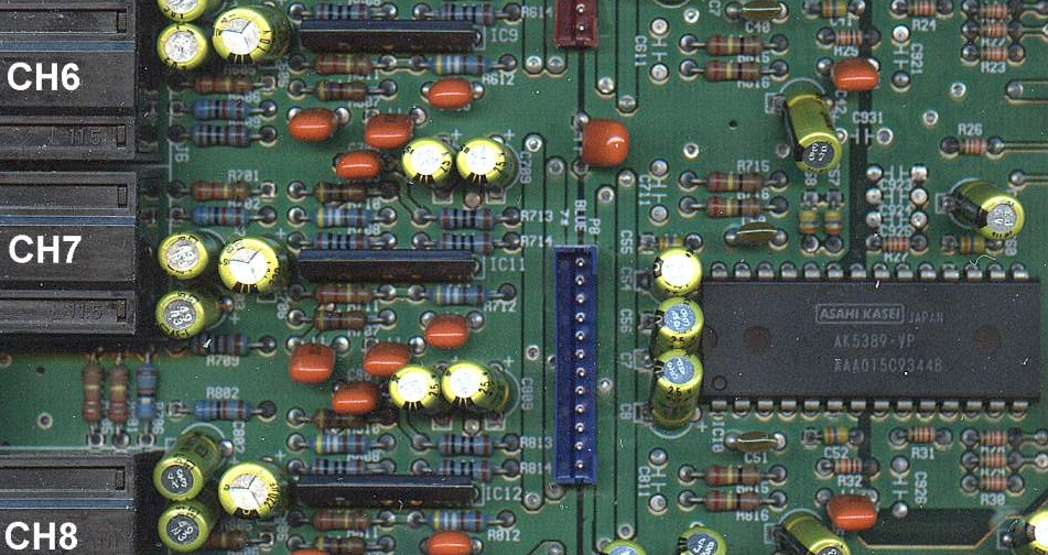

Outside of Marketing doublespeak, which may, or, may not have any bearing on sound quality, what converter of today sounds better than these old AK5389 ADC from around 1995 : )

I cant tell unless you post spec's......er... and brand name and cost..if it costs a bunch it will sound better.....ahaha
ok joking aside... well I probably spoke too soon, thats 18bit right?
Asahi Kasei....brand.
heres the datasheet
http://www.allpartsdata.com/show_allpartsdatasheet.php?status=true
I agree with Chili on the interface, those Apollo's are hard to beat and youre in a great upgrade space with "comps and preamps" onboard, its decent pricing considering all you get. Im not so shure Thunderbolt will last long as USB-c or whatever is coming around the mountain ahead of schedule.

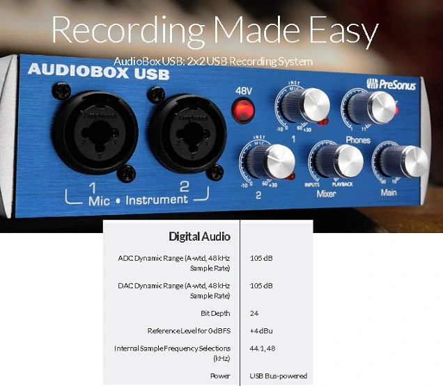

It's still 16/48 era, but they sound good. The front end isn't anything special, but I can use something else. I bought this for the PCM1702 DAC section, though.
With modern stuff, its still the basic circuit sections Line in, MIC preamp, clock circuits, converters, output sections - and the Feature stuff. In theory, some $1000 One Knob should sound better than a feature packed $1000 interface.
You know I bought that $25 pocket AD from China that I can plug any front end into.
Thats the point probably , they all sound good at some point in time..maybe it was the 1990's?
Maybe 16/44.1 was the line in the dirt. I just bought some preamp with 20bit or 24bit but 44/48.
WIki mentions 1950 converters started, gates and capacitors or something...so for some time the converters might have been pretty bad, maybe ok for machines not audio.
I guess using 16/44.1 CD's audio world as a comparison point...16/44.1 is ok? marketing aside of course.
the OP has this Presonus...24bit 48k, USB powered so 500ma max, USB-C is coming...I'd wait for that for an upgrade maybe. USB-C 1.5A & 3.0A....theres some juice for the preamps and headphone amps.
