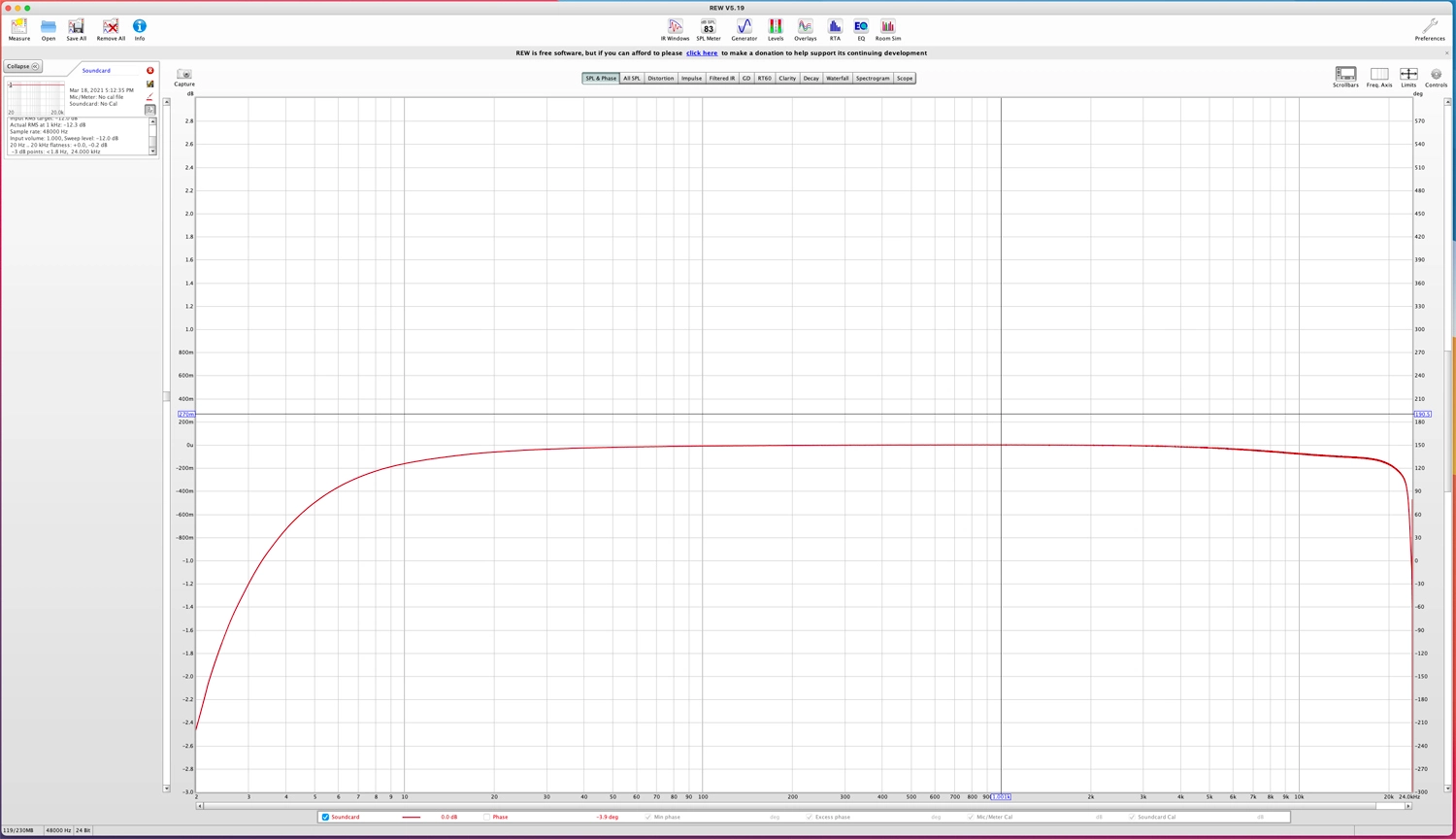

I guess a lot depends on how good the analog output is of your computer sound card and how well it interfaces with your monitors. Laptop outputs are not always great and can be prone to noise but not all. I imagine you are mixing these virtual sources intending them to at some point be heard in the analog world.
REW (Room EQ Wizard) software, when you set it up, has a soundcard calibration utility. You make up a loopback cable (out to in) for your computer and run the calibration. It will tell you how good the soundcard
response is. This is the response of a cheap Behringer interface. Very flat response even down to 7Hz and up to 20k.
