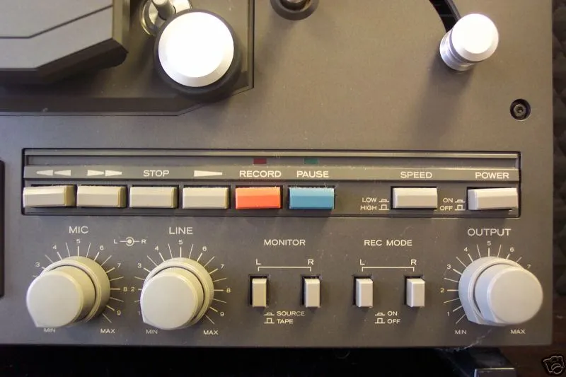

Hello!
This is an up close and personal view of the 22-2. This configuration of switches implies that it does track1/track2 sync, and I don't know what it'd be for, if not that.
To me this appears to be a 2-track/2-head deck with the requisite 1-2 overdubbing capability. I don't see switches that denote a seprate Sync/Repro head. In most modern recorders I'm accustomed to, the Record/Reproduce head does the "sync" function by itself, based how it's switched through the electronics. All cassette Portastudios are 2-head sync capable decks.
I don't wanna go too far out on a limb on the 22-2, considering I don't own one, but the 32 is a 3-head deck that does tracks 1-2 sync/overdub, and that I know first hand.
I'll just have to beg your pardon for my ignorance if I'm wrong. :o :eek: ;)

Good questions... but remember, the 22-2 and the 32-2 are still three head decks. How it is setup is that you can "arm" (for record) each track seperately, and the same for "monitoring". However, to monitor, you are monitoring off the INPUT (source) and NOT the record OR playback head. And...as we all know, the symul-sync feature allows monitoring (temporarily)off the record head to keep things all sync'd up. (I think machines like the 38 were the first decks where the playback head was actually redundant, as the record/playback head had basically the same specs for playback)
As to why you have that feature, I might assume for NON critical sync'ing so you could overdub.. An example might be narration over background music. (then mixed to mono, I would guess)
Or...if you are just recording a mono source (like narration), you could technically just record one channel, and be able to rewind and double your available record time by recording on the other channel. (or just flip the tape as you would in a 1/4 stereo format)
Just my opinions and (guessing at facts, maybe..and stuff that we all probably know anyway!!), the 22-2 basically came out so the home user could afford a 1/2 track machine. At the time, the next cheapest machine was for a used pro machine...about 5 grand at the time (maybe?). Also at the time, that was basically the only format radio stations really preferred, record dup plants wanted..etc ....so if you were doing jingles, making 45's or LP's etc... you could "get into" the format without selling your first born.
I remember buying mine new for around $800 at the time. However, I also believe the S/N wasn't anywhere near its bigger brother the 32-2, and especially something like an Ampex, MCI, or whatever. I think it hovered around the low 60's...maybe. You HAD to hit the tape hot, but you could, as I almost always pegged my meters until my EAR said "no".
Oh yeah...forgot the Revox stuff. ...about twice the price, maybe?...wasn't it? Actually nicer machines (than Tascam) I thought. ...the PR77..or something like that (boy, its been a looong time!)
EDIT... nice pic (above)
but...see my explanation above.
Believe me, if you COULD sync, the 22-2 would make a great "jam along" machine for quick and dirty. But, it didn't :(
btw, notice that you did have mic AND line input controls. In addition to the output controls, they were separate L/R also..,..rather than just one control for both sides.
A high impedance mic and a line in was a good combo!! ;)
