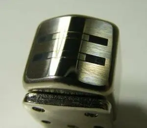

Not really... the machine isn't designed for it. To do multitracking, you really need the 2340 or 3340. They have what Teac dubbed Simul-Sync. This allowed the record head to be used in playback mode. Playback fidelity wasn't as good as the actual playback head, but you could select which tracks were recording and which was playing. You could record on 1, play 1 and record 2, play 1&2 and record 3. Or record 1&2, then play 1&2 and record 3&4. Since everything was done on a single head, all track would be in sync. Once you dropped out of Simul-sync, everything would be played back on the playback head with full fidelity.
With the A2300, the record head only records and the playback head only plays. Since they are physically separated by about 3/4 inch, the two will never be synchronized. If you look closely, you will see that on the A2300, there are only 2 recording tracks per head, not the 4 that you have on a real 4 track machine. So there's no way to record more than two tracks...
