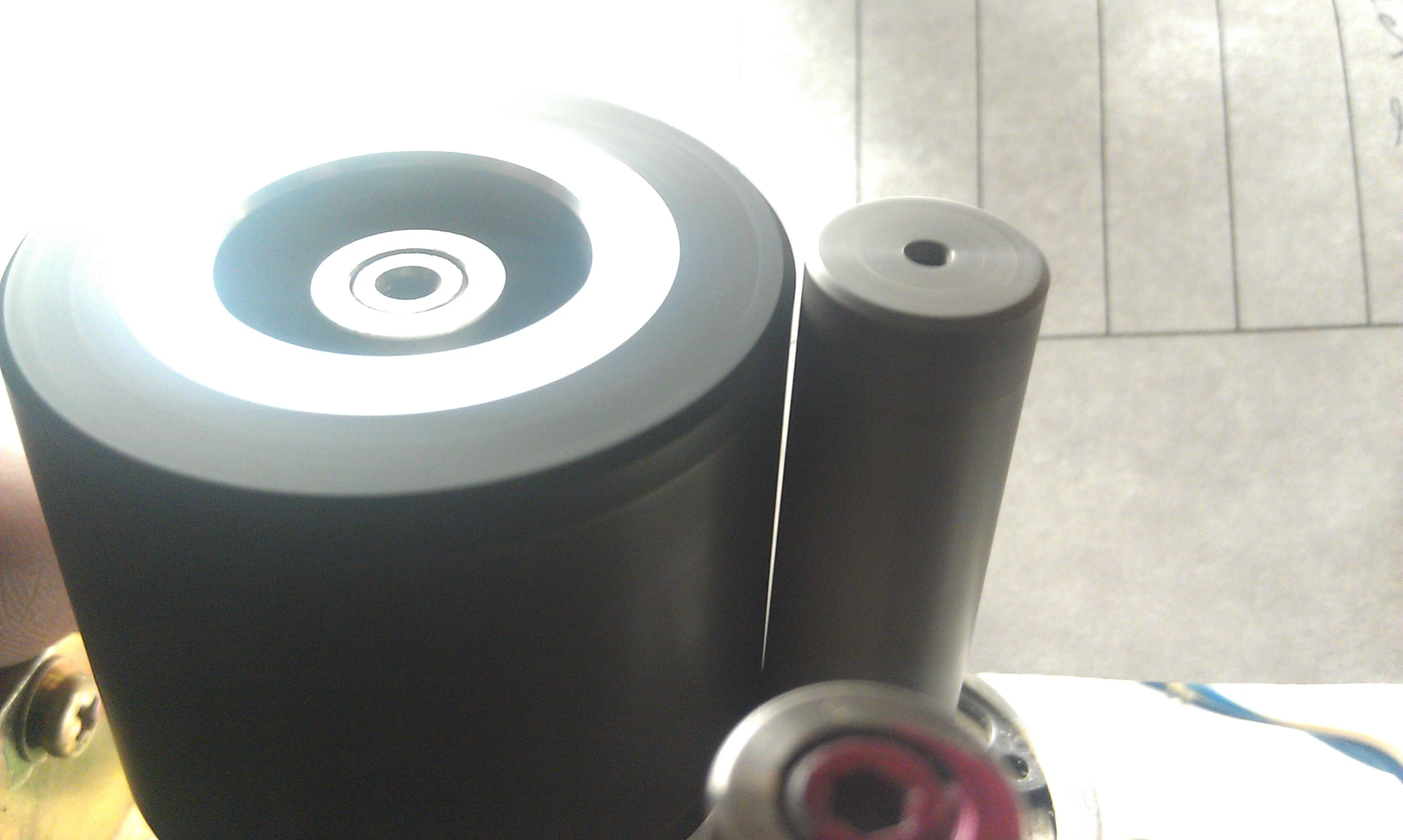

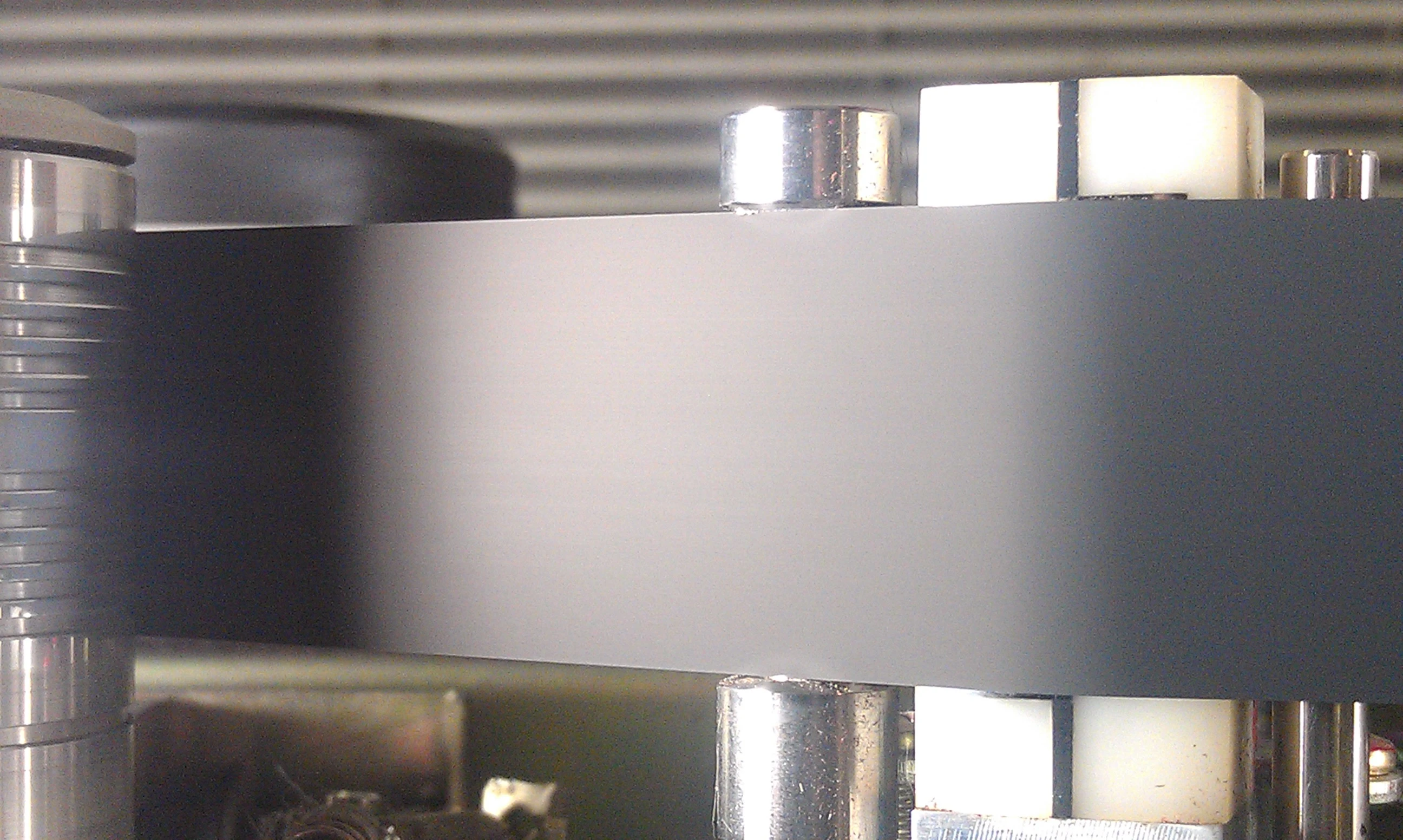

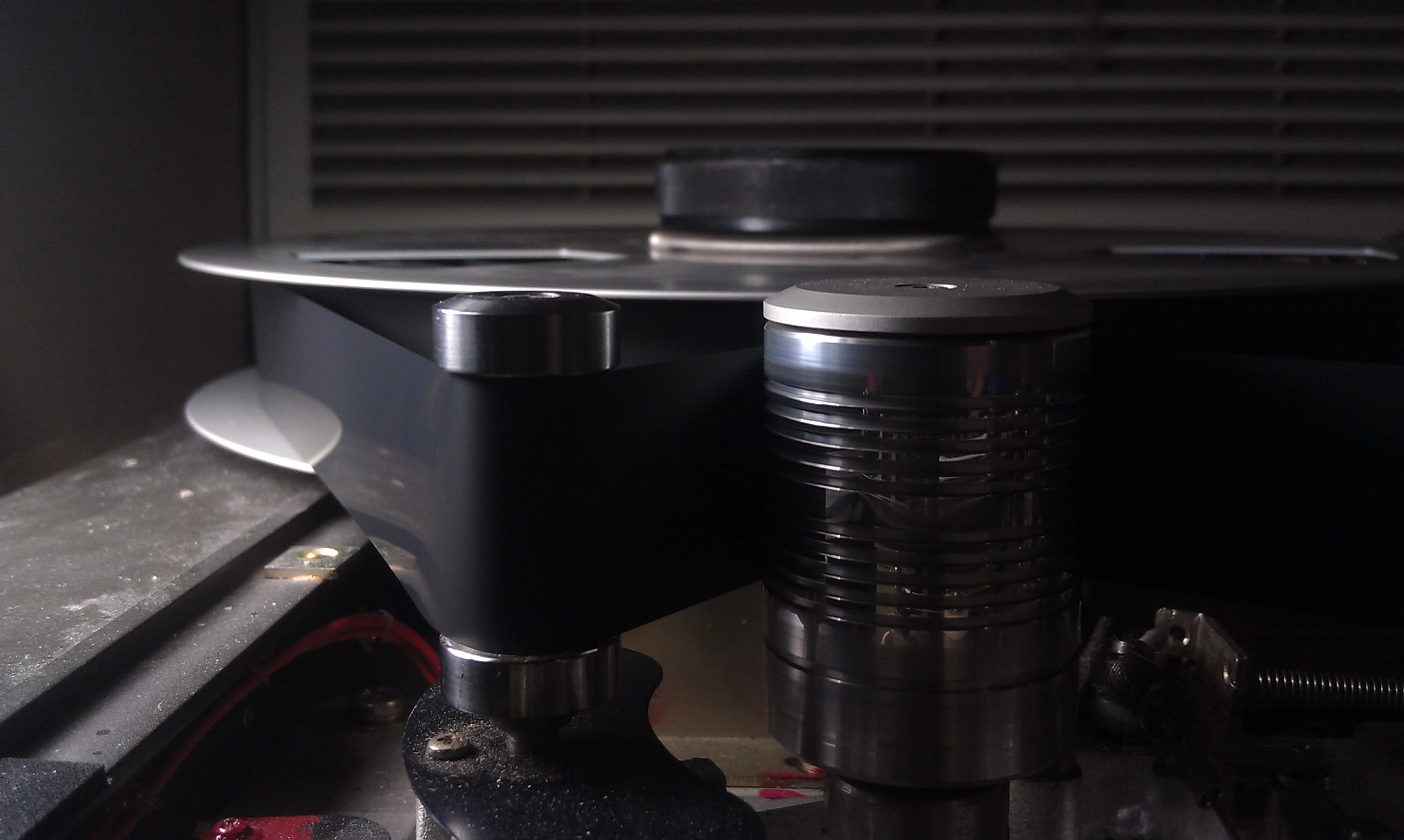

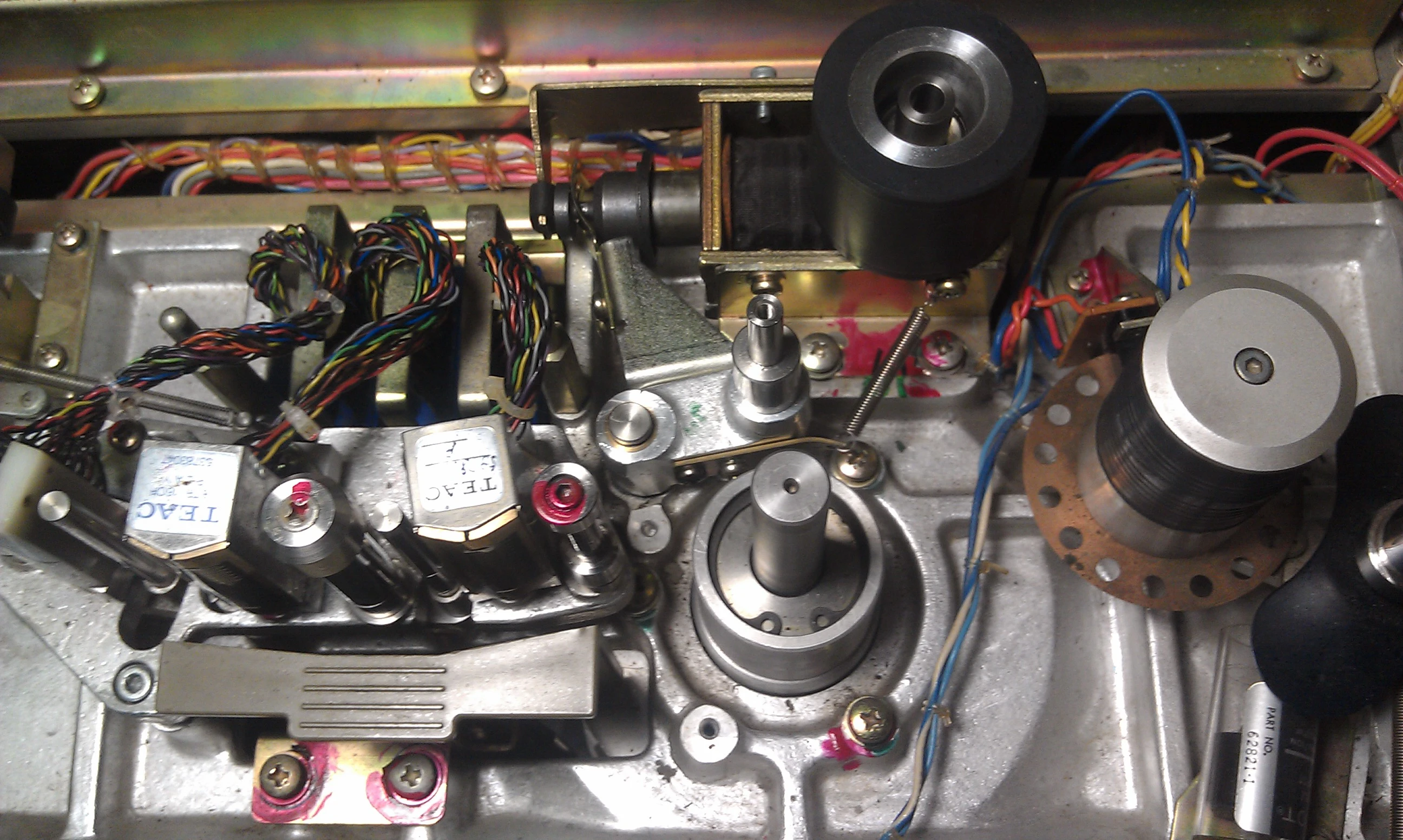

Huh, I was able to get another roller arm from TEAC - p/n 6014103000. Cost about 82 bucks! I put it in and now the pinch roller hits the capstan exactly parallel, as well as my eye can see. It surprises me that a die-cast part could become deformed like that, but it evidently was.
die-cast...formed steel...machined...doesn't matter. It all has limits.
So the question is, how does it pull tape??
It's looking a lot better - there no longer seems to be a big tension skew around that supply roller. Know a good source for a spring scale? The service manual says the pinch roller pressure needs to be 5.5-6.6 lbs

Seem to have licked it, yeah. I still haven't got the spring scale to verify the pinch roller pressure is right.
