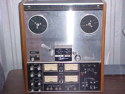

I just scored this machine from a co-worker. It was really dusty, and a bit dirty, but a couple hours with a fine brush, compressed air, lemon oil, and alcohol cleaned it up nice. It appears to be in pretty good shape, but it's missing the tape stop arm. Will it run without it, or do I need to bypass the switch?

Found a decent pic of the same machine:

Rather then by-passing the "stop arm" as you described it, it might be better to try and get that fixed as it also serves as a tensioner arm to keep the tape from spooling poorly and getting stretched.
I used to have one of those machines too and it was capable of making a great recording if it was calibrated properly.
In what way is it broken or gone, ( the right tensioner, I mean).
Post an actual pic of your machine so we can see the damage.
Cheers! :)
It would not be impossible to fabricate a new tensioner arm as I had to do until I acquired one from a junker I bought for parts.
If you have the original Machine (without solenoid control of the tansport) be prepared for trouble with the silver transport switch.
The tape reel clamps also tend to break easily.
