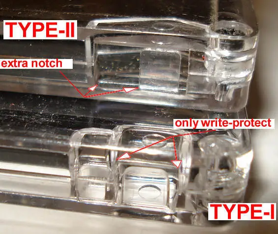

if you find some bulk cassettes with no lables and you are not sure what type the tape is, you can look at the notches (where the write-protection tabs are), see the picture attached:

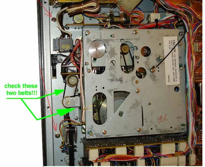

TEAC 144 Portastudio problem - please help
I have a problem with at TEAC 144 I bought recently. I couldn't find a better place to ask my question than here. I really hope you will help me out.
Whenever I press play, fast forward or fast rewind, the recorder stops after about one second. If I hold down play it plays like normal, but if I let go it stoppes immediately.
Do you have any idea about whats going on?
I really hope you will help my out. It not easy to find experts one the machines anymore. At least not in Copenhagen, Denmark. :)
Dan
Dan,
remove the bottom cover. It's easy.
Then check two small bets 'associated' with tape counter mechanism. See the attached picture, pointed GREEN.
These two belts (BOTH of them!!!!) MUST be nice and tight (so they dont slip). They can be broken, completely melted or just stretched and hanging there.
If that's the case, then you get what you describe.
post an update when you get there. Also check the other belts condition as you are there anyway :)
