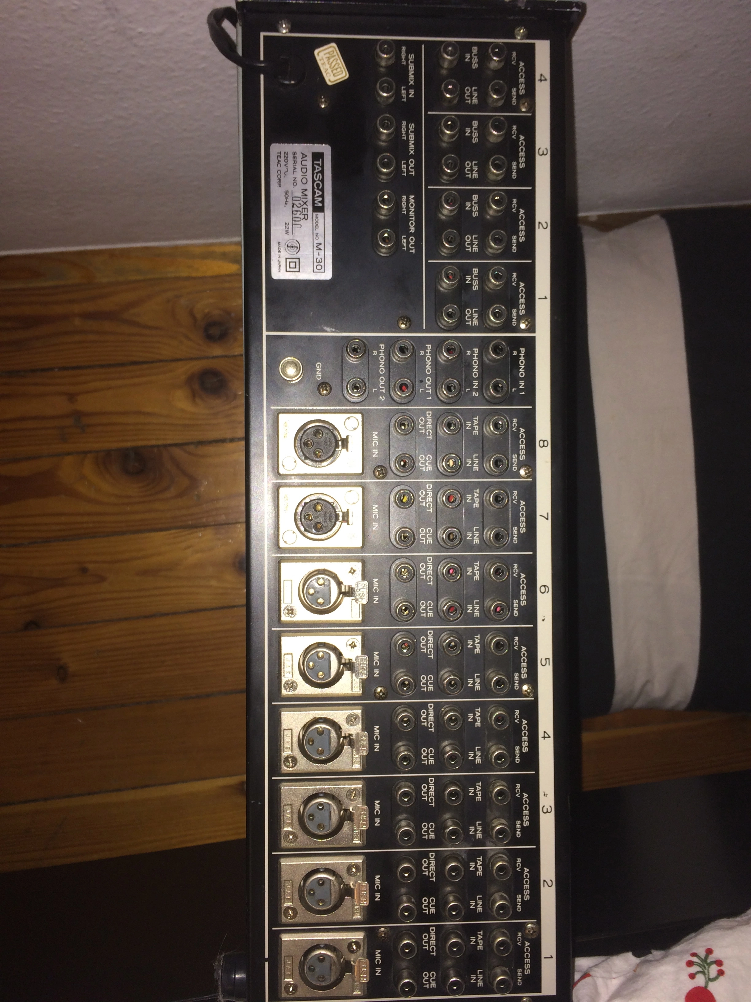

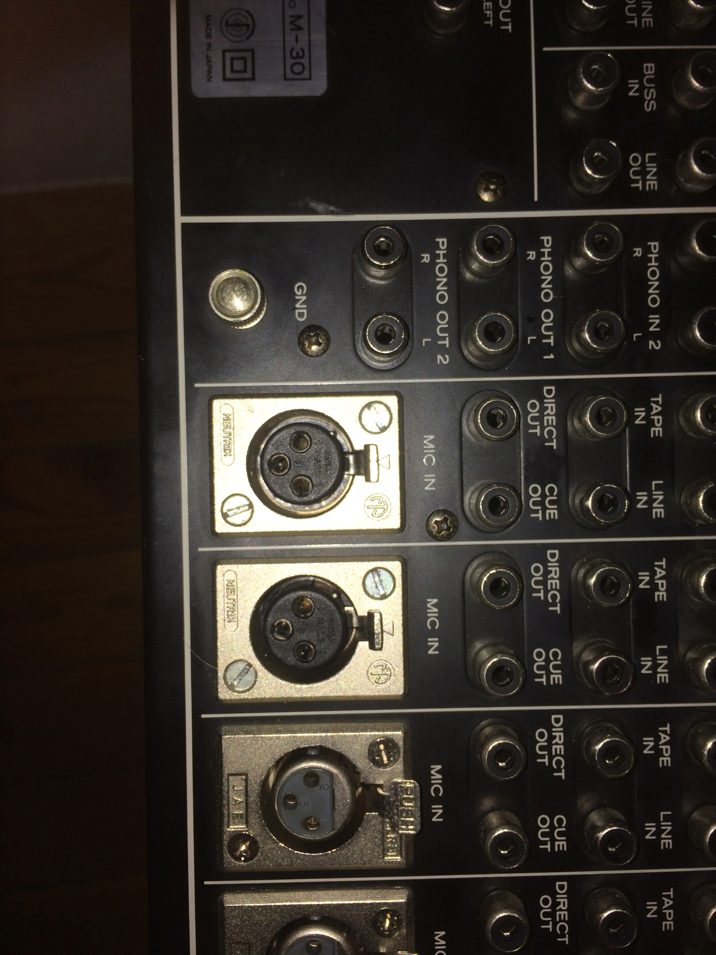

2. I read there should be 2 1/4“ inputs on channel 7,8 but there are two black xlr inputs looking different than the other silverish ones from 1-6. Does this mean it is moded or something else?

As far as the XLR inputs on channels 7 & 8 can you put up a picture?

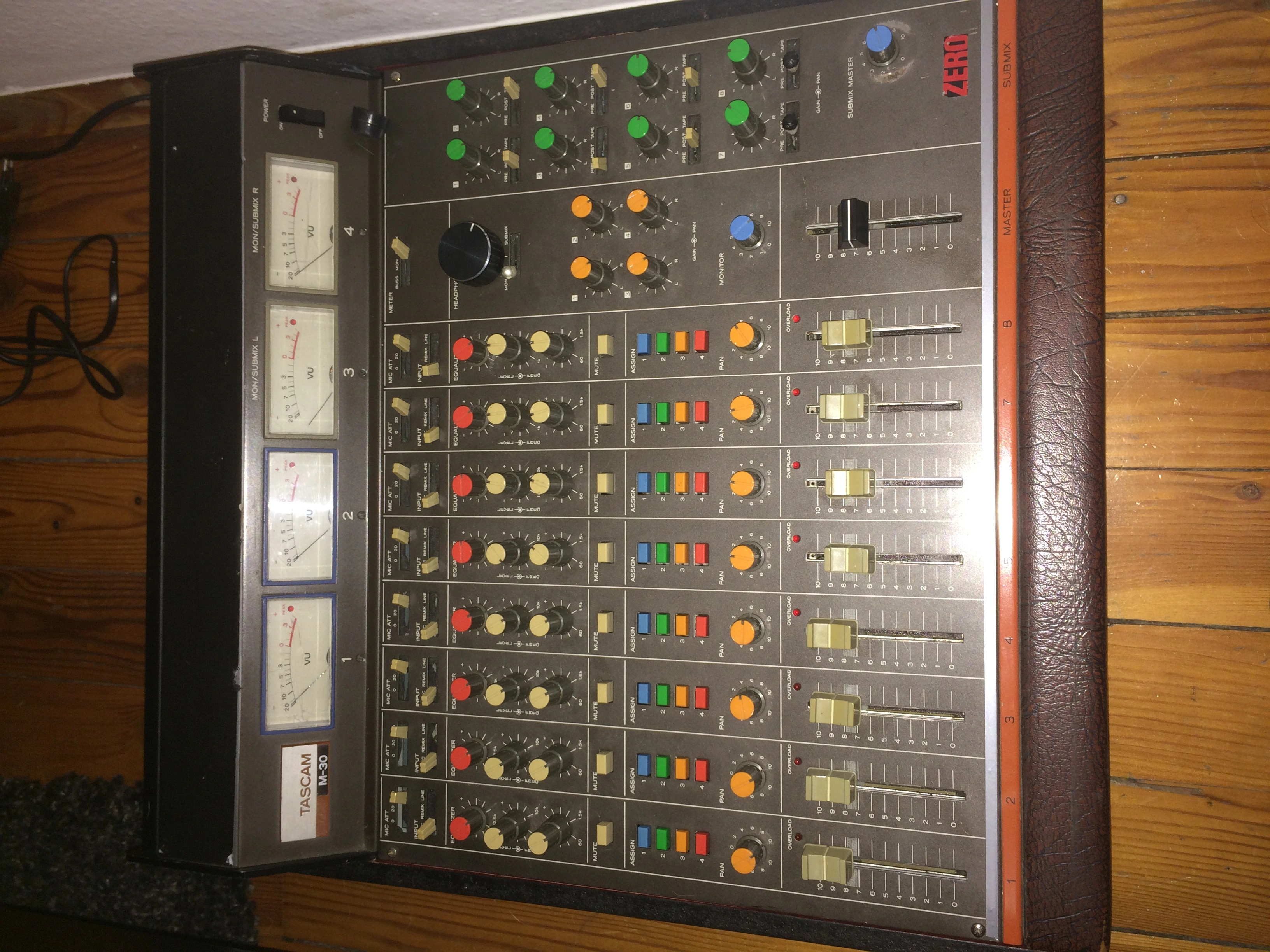

Thanks for the answer Sweetbeats, you totally got that right what I was trying to say. Trying to get simple Rca/Rca patch cables, thanks and I am using the 4 Jacks from my 244. As for the pictures: I just realized that the headphone knob is also not original and must have been changed since it is HUGE and the VU needle 3 looks different from the rest, this was also probably changed. I googled the M30 and saw a couple of pictures where there are also only XLR inputs and no 1/4". Is there a possibility of a different year of production and / or different region? Eq american/european version? Despite all that it is in pretty good cosmetic condition (despite that darn ZERO Sticker at the bottom right corner) and I am glad I scored it. It's very similar to my Tascam 244 Portastudio with the flip switches I hope everything will work.

Regarding the meter, was that picture taken with the mixer turned on? If not, what happens when you turn it on? If so, what does it look like when you turn it off?
Regarding the channel 7 & 8 XLR jacks, no, not later model/special model/European model...the original 1/4” jacks are high impedance unbalanced mic jacks. My hunch is somebody swapped the 1/4” jacks out for XLR and they are still unbalanced, but you wouldn’t know for sure until you remove the bottom panel and post some pics of where the wires go from pins 1, 2 & 3 of the XLR jack. In the meantime we might be able to get some answers if you have an multimeter, you could measure the resistance between pins 2 & 3, pins 2 & 1, and pins 3 & 1 and post the results here.
When I bought my M-30 back in the 80's channels 7 & 8 were ¼'' jack for high impedance microphones. Apparently, there was a conversion kit available for converting to low impedance balanced. From what I read, it included an impedance matching transformer, but I don't know what else.
The original headphone knob should be the same as the monitor and submix master knobs, but with a green cap, the headphone toggle switch top should also be the same as the toggles at the top of each input channel.

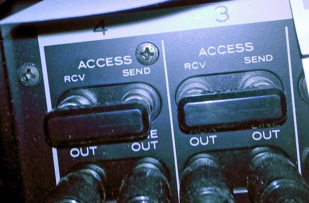

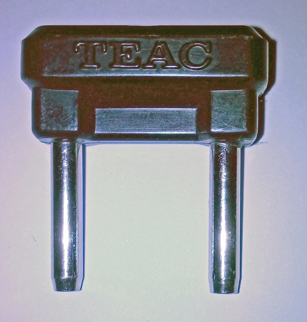

Two photos below of the access send/receive jumpers as originally supplied when new.
View attachment 101238View attachment 101239
Thanks for the info and the download link I only got the operation manual with it! As for the Jumpers, I think I will get the rca short cable by this french seller since they are cheaper and should do the job. I can‘t wait to hear it hopefully everything works smooth.
