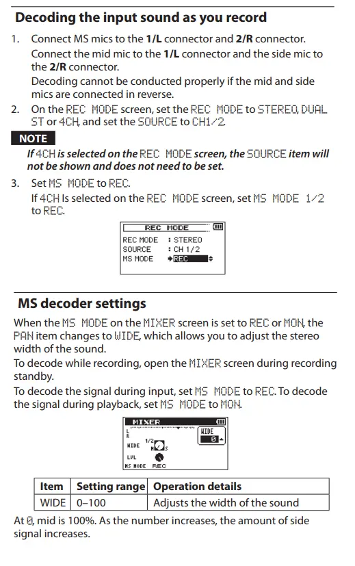

I don't use this, so I checked the manual.. does this help any?
CLICK to ENLARGE
