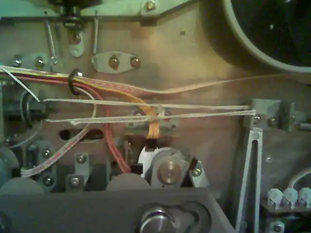

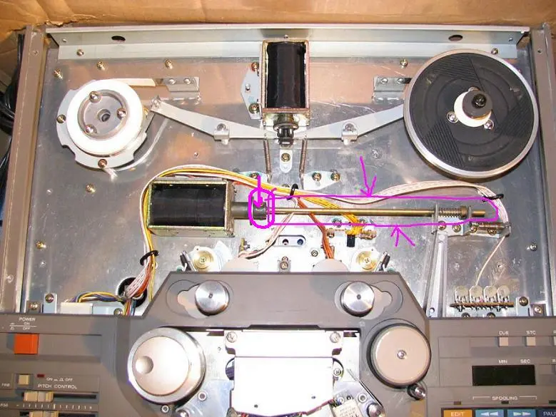

Sweetbeats , I sent you a PM about the linkage. I could'nt post fotos in the PM so I posted them here.

It is mind boggling what people will do with these great machines. I bet the part could be made up from parts from McMaster Carr- I was taking to a guy who had one like this. I have a lot of customers call me and say they would love to have a 58. Of course with the rod in it. I am in the chicago area. I actively repair these decks so that is why I have a lot of contact with buyers.
Please post the information in the PM here in the thread. There isn't any reason to keep it private. ;)
Do you still have the Tascam 58 parts deck ? I need the linkage rod assembly. Heres foto of what I need. Mine has string.
