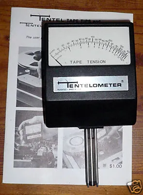

Well, is it truly that way? My 48 and 58 are that way as well. In other words, the manual walks you through where to position the tension arms, but then the Tentelometer is used to double check...I guess more if something is still wacky after positioning the arms correctly...but does the 388, like, not use a Tentelometer for ensuring proper tension? Like there is no way for the tension to be out if the arms are in the right place?

only the most esoteric of hardcore analog freakz actually has a tentelometer. Actually, that meanz I should probably have one, but they don't exactly grow on trees.:eek:;)
Then I guess Cory and I must be hardcore!:D We've got to hook you up, Dave, with one of them tentelo thingies..:D:D

Well, you may recall that when e'thing is in the right spot on my 58 the tensions are wacky...it doesn't hit the sweet spot, so that's what I'm driving at...all posible causes to this point have been exhausted except for maybe something faulty on the control board...so...anyway...
Hey...is that MY Tentelometer in YOUR post?! :eek: What is it doing THERE!??! I'm going to check and see if its still here... :D
