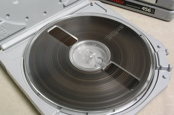

the tape/reel looks similar to this (attached) 456 tape photo (found at e-bay):

Provided the recorder was not setup for another type of tape by the previous owner(s), the TASCAM 388 was originally aligned for Maxell UD 35-90 (now discontinued). The tape can still, however, be purchased on eBay.
Whatever tape you use, one must realize that any recorder of this age drifts out of alignment (both electrical and mechanical) and would need to be readjusted.
If you wish to get some newly available tape, then there's the excellent Emtec RMGI LPR35, Quantegy 457 and Quantegy 407. All are 1mil tapes as per factory recommendation.
Musicians Friend doesn't have any 1mil tapes and the closest is the 456. I personally wouldn't use that on the 388, even though there are some that use the thicker type without any problems and getting good results. I'm just going by what is officially recommended and my own preference. You want to look at 1/4" x 7" x 1800'
This is what you want to get (ignore the picture):
http://www.zzounds.com/a--2676837/item--AMX4571511J1
... and / or this:
http://www.usrecordingmedia.com/rmlp1x18sub.html
PLEASE NOTE that you will need to have your 388 readjusted for these tapes for best and most accurate performance.
