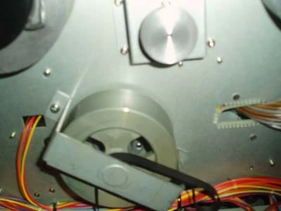

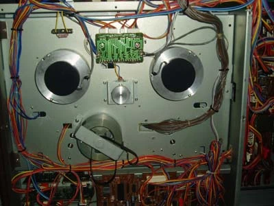

I opened up the back and sure enough the belt was not connected properly. I'm assuming that was my problem. The solution looks easy enough, but i don't want to take any chances and screw the back up not totally resolving me problem. I'm posting pics so you can see what i'm dealing with and tell me the best way to do this.
thanks alot,
lofipower

another pic
heres an up close pic
The belt was obviously loose,...
enough to fall off under it's own weight when taken for a bumpy ride.
It's probably best to source a new replacement belt and replace it. You'd have to loosen and partially remove the flywheel bracket, just enough to sneak the new belt over the flywheel. :eek:
