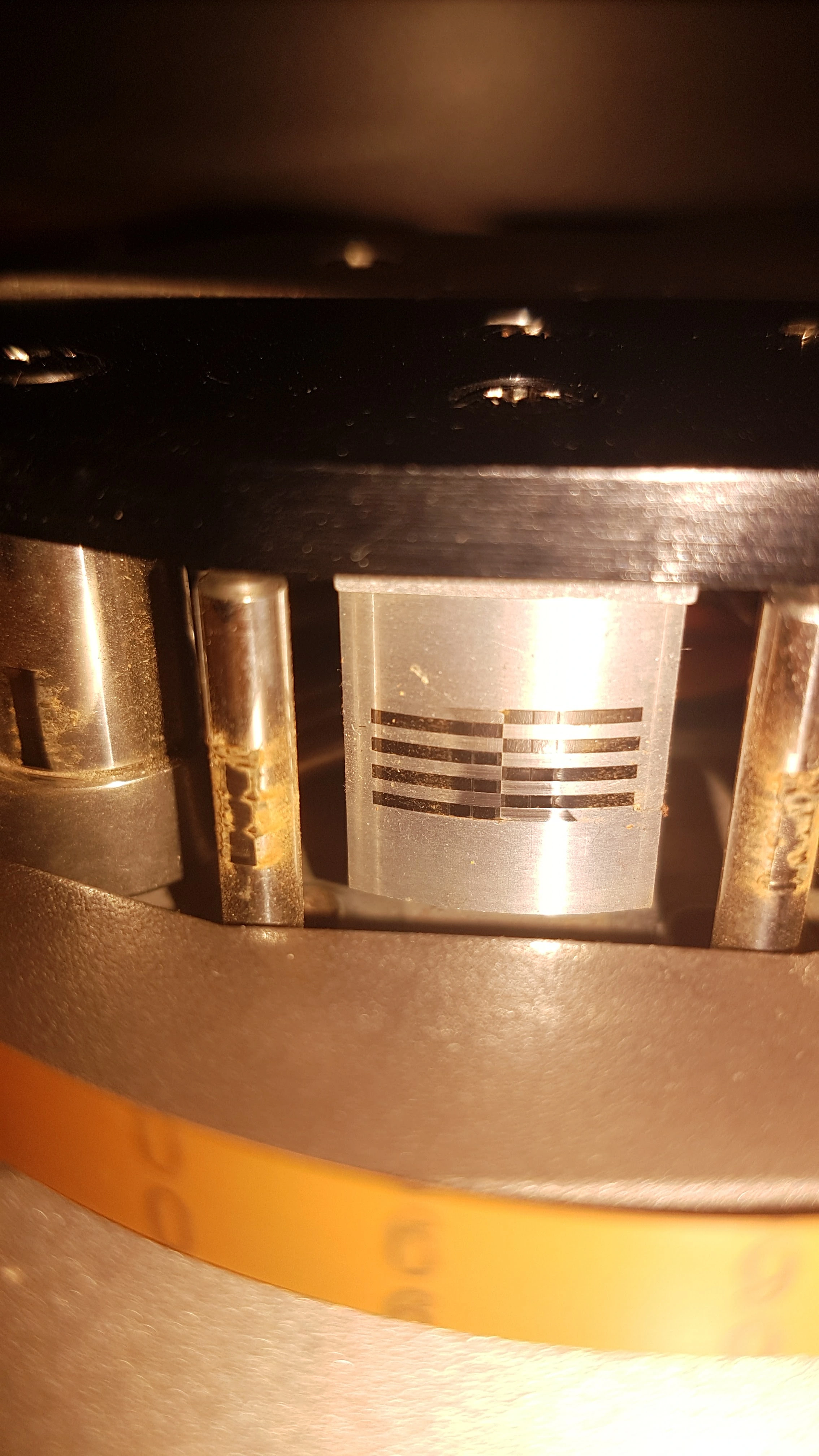

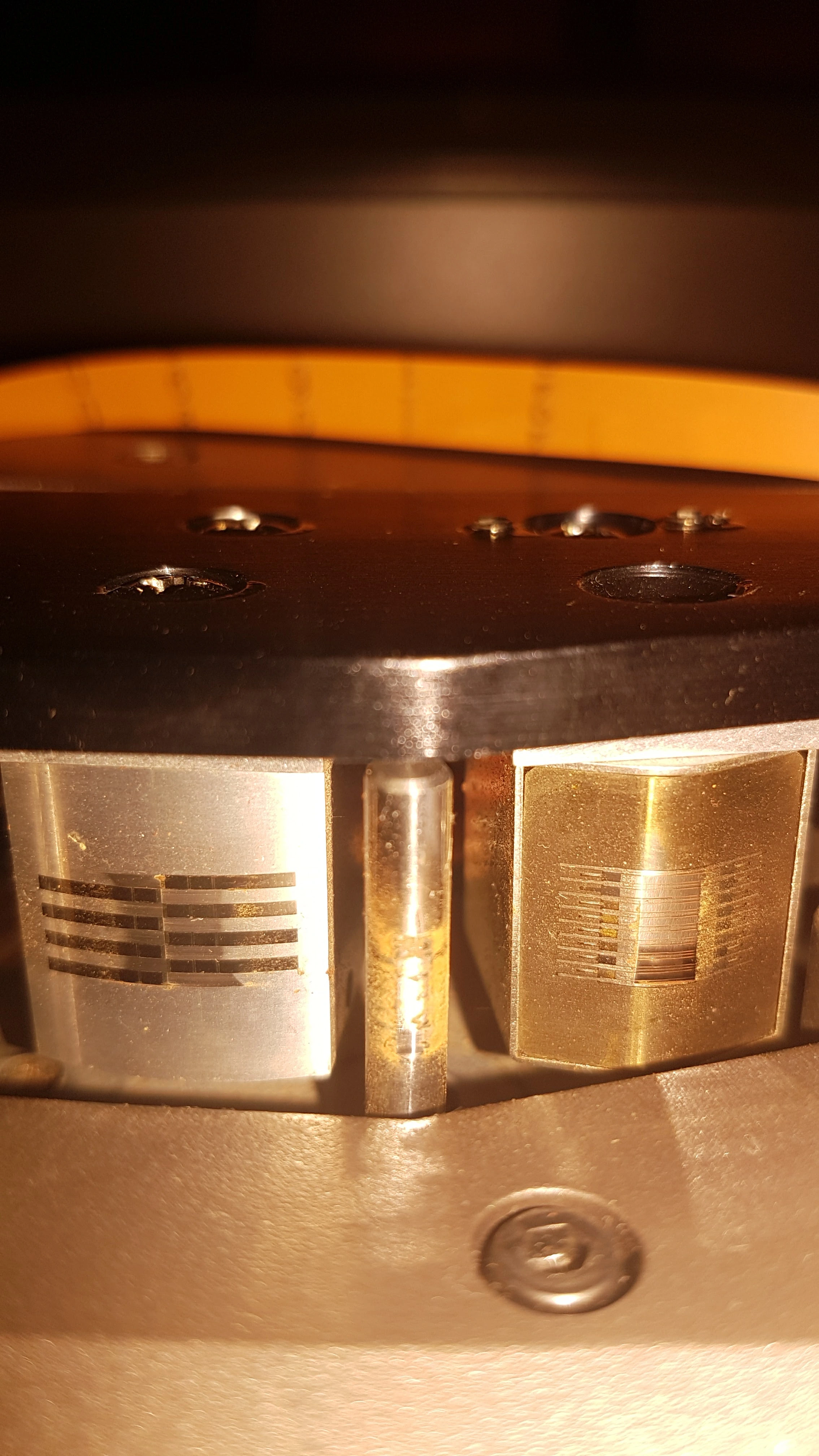

Now one thing that seems fine to me but i'd surely like some opinions are the heads

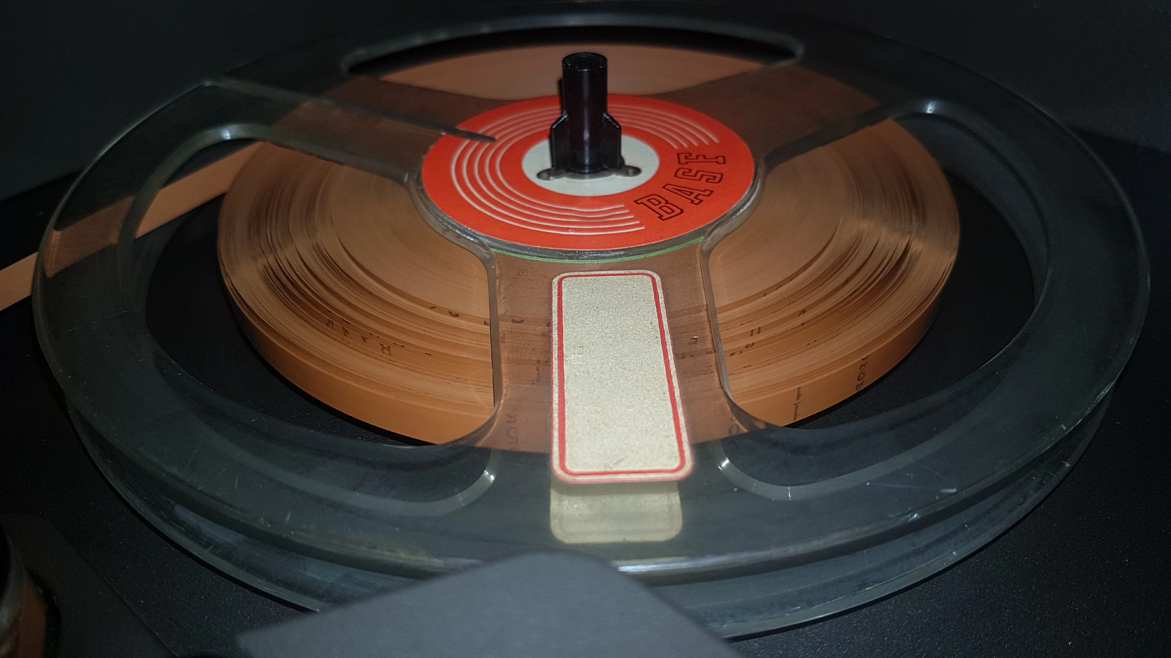

My tascam lays tape from one reel to the other in a pretty rubish way!
Ive had experience with studer machines and although i don't expect the same result , i think that it's so bad that it represents a problem.

Secondly, please clean your tape path. That's #1. Your guides and lifters are caked with what appears to be old sticky-shed residue.

Something is not right with your tape path...the tape pack does indeed look like rubbish. I think you need to take care of that problem first and then the volume variation might be fixed as well.

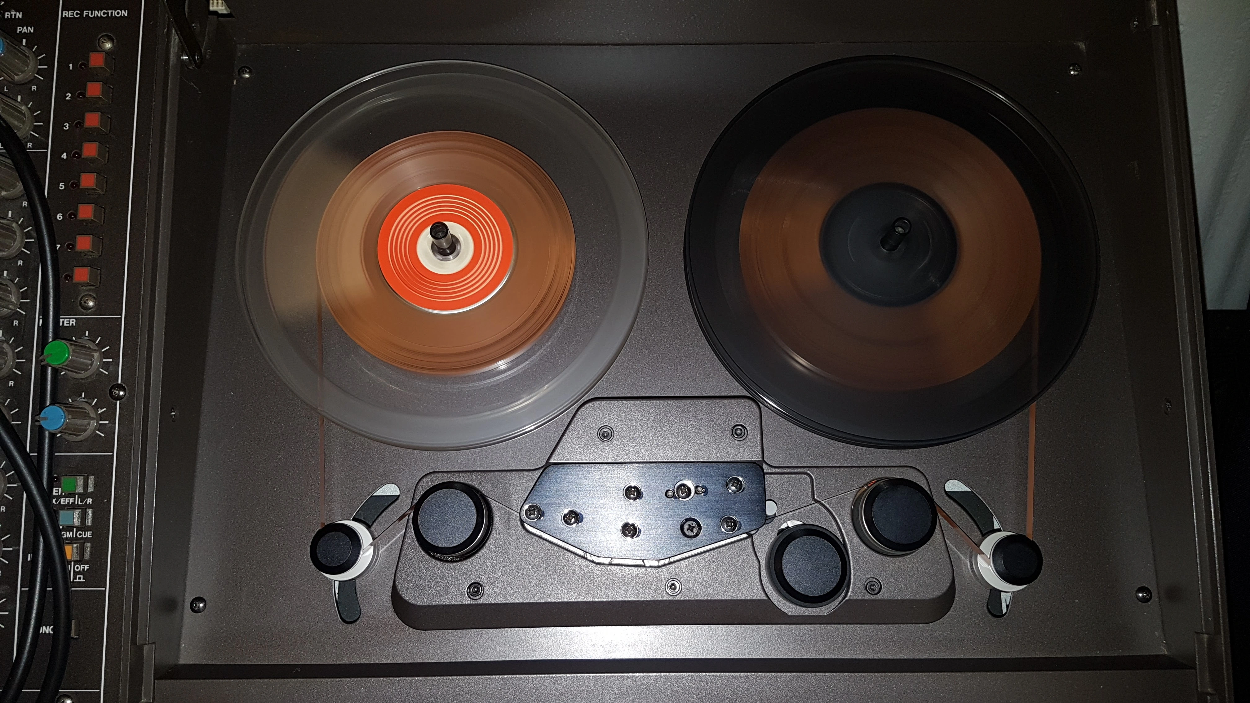

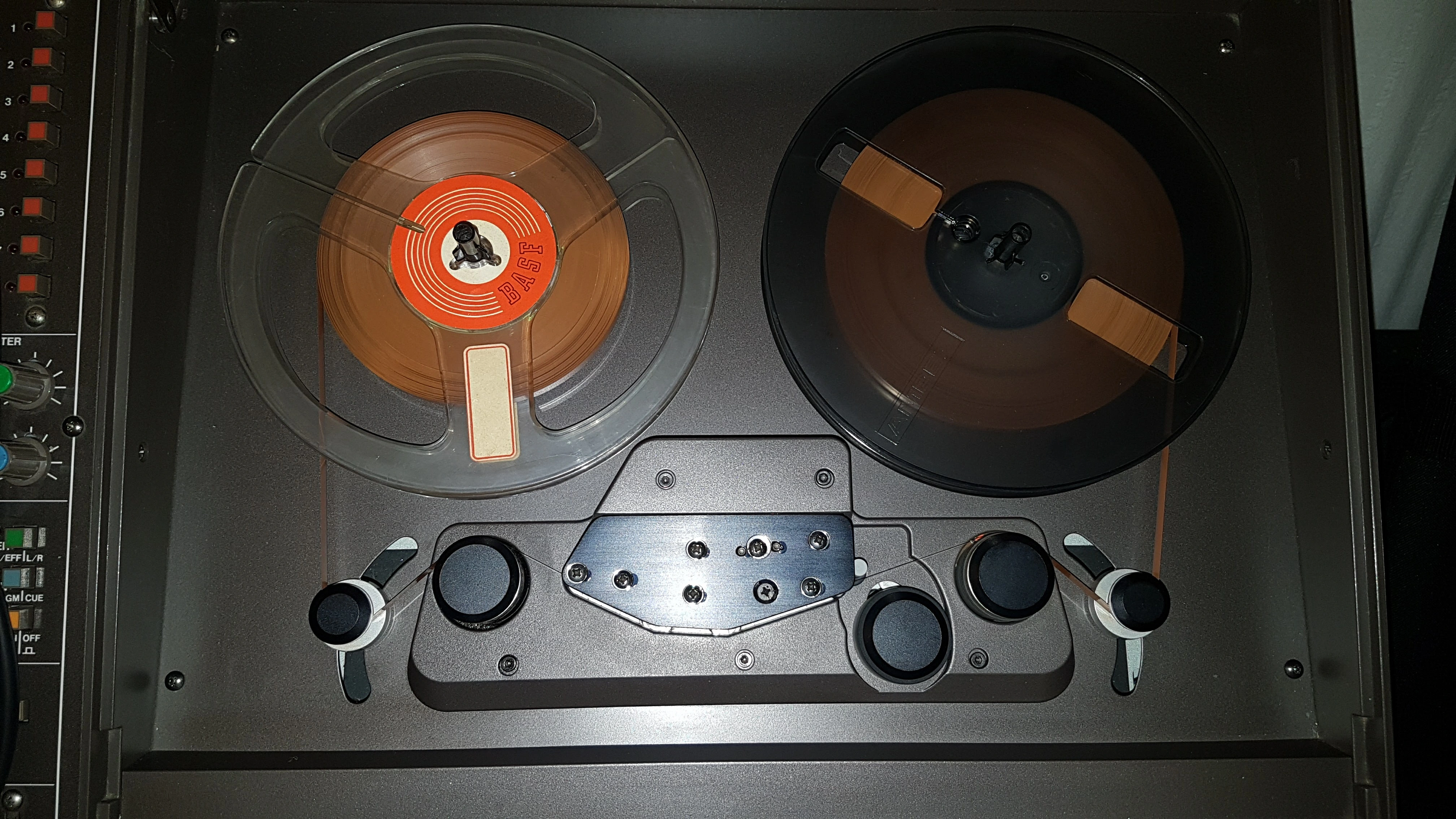

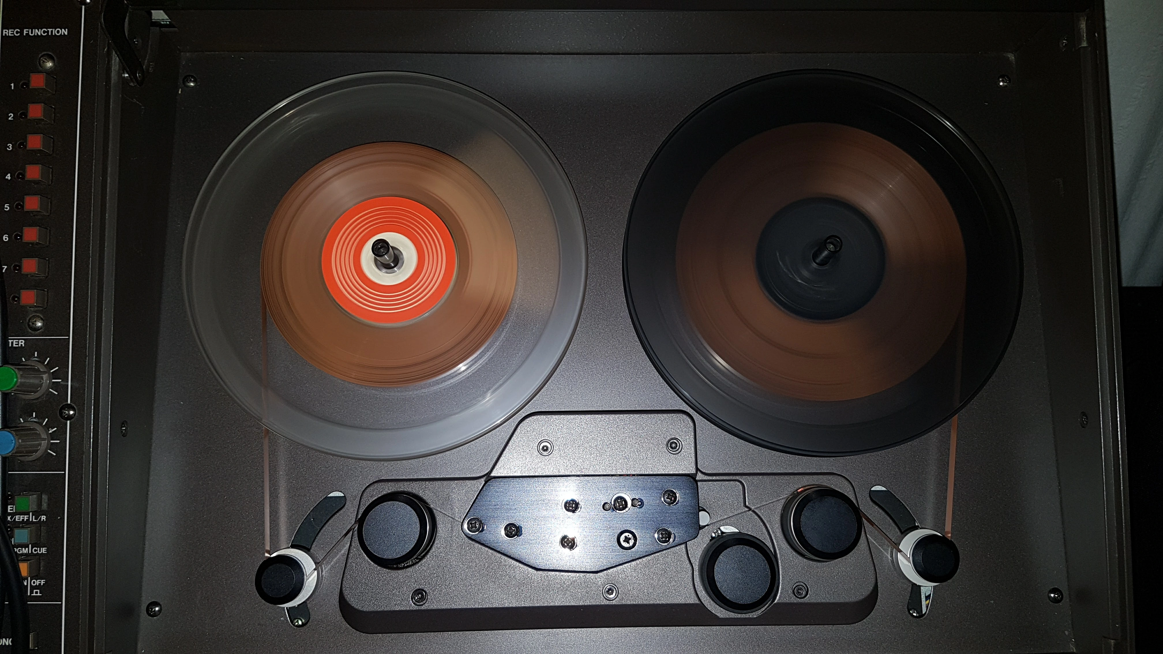

Ok i did the job! , cleaned the heads , I also got photos of the swing arm position in the 4 states and got a video too
ok
Stop:
Play
FF
RW
the video is on its way!

I think you're going to have a hard time getting a good tape packs with that type of tape on fast wind. I think you are simply having float issues...the reel and tape are moving fast and air gets in between the layers as its winding and the tape shifts around. What happens if you use the spool wind mode?
Your pinch roller looks shot. If I'm correct, all bets are off getting even consistent record and reproduce performance on all tracks until it is replaced.
Also, clean the entire tape path...the impedance and counter rollers (the big roller to the left of the headblock assembly, and the one to the right of the capstan shaft) look soiled.
