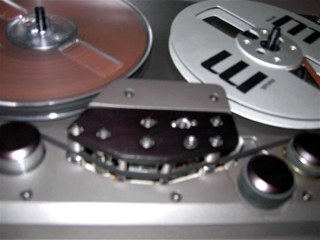

Sounds like you have the tape routed around the wrong side of the tach wheel. Thats the far right big roller right before the right hand tension arm.That would make it count backwards.
Move the tape to the other side of the roller.
I have swiped someone elses picture here, but it shows how the tape should be threaded
I dont know about the not stopping in fast forward problem however.

Thanks so much for the help guys. Indeed, it was the tape path:o. I just figured the previous owner would have loaded it correct, but no. LUNE! Crazy! Glad to find this site and you on it. We'll have to nerd out on our 388's soon (Miki will probably stay home).
Did that also fix the FFWD problem? The transports tend to get a bit confused if the tach signals are incorrect so I wouldn't put it past it.
Yup. Fixed all problems- acting as it should now. This thing is so cool!
