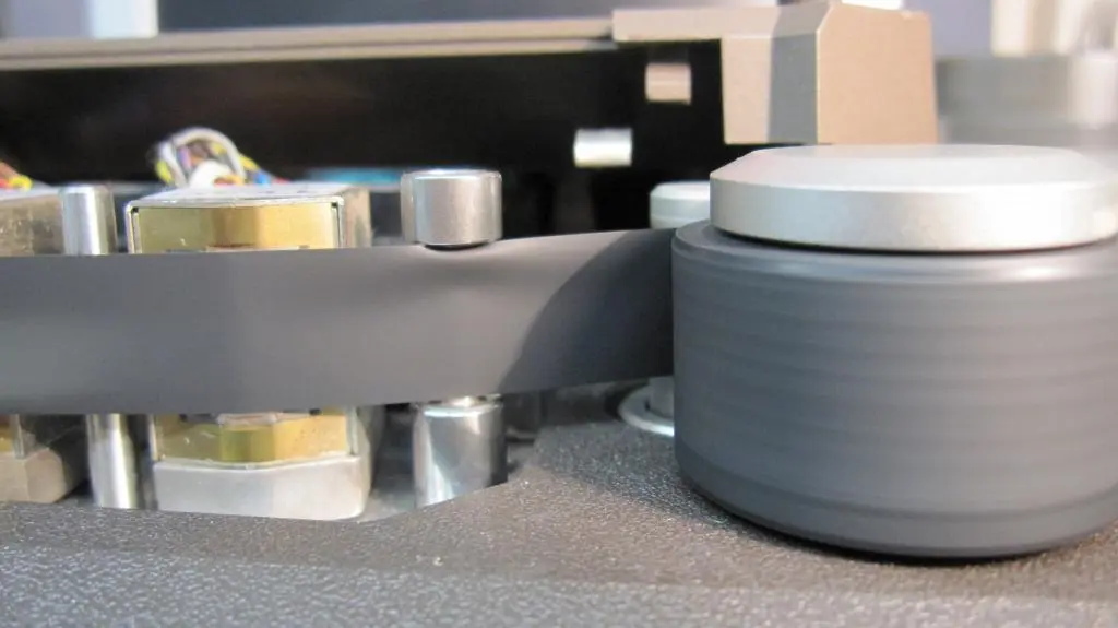

Sorry for being pain in the ass but i need to ask you again about my maschine.

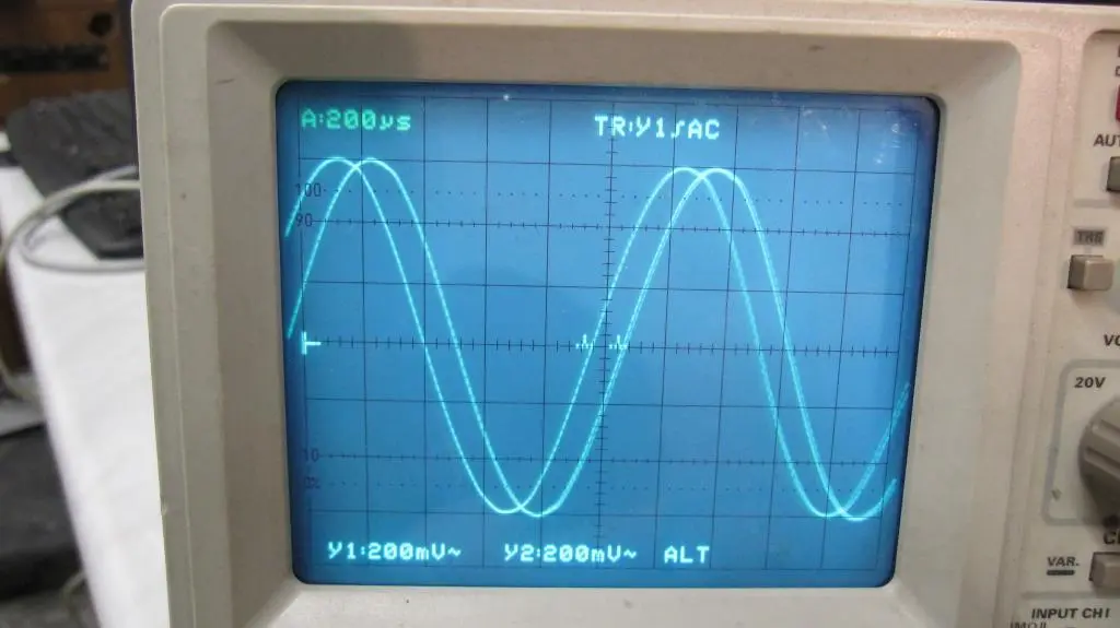

Just take a look at a picture, it looks like pinch roller is putting more pressure on one side of capstan. In result, as you can see, tape is not rolling even and it is rubbing one side of the guide. I had this before, but I thought it was because of old/melted pinch roller. Now I have changed pinch roller along with capstan belt and after turning it on, it seemed ok, so we started doing some alignment/ calibration. Ater a while (1h maybe) we have notieced out of phase signal between two output tracks on a oscilloscope (picture no 2) We were plaing back tone from the test tape. I looked at headstock and notieced the problem went back
For us it looks like the metal part that is holding pinch roller is not 100% still. It seems to be little bit loose on its mounting. Not very much like maybe 0.5mm. In result capstan and pinch roller is not 100% parallel while prssured. Im not sure you can see it on a picture, but even without pressure it is not parallel, I think.

The only thing I'm noticing is that the pinch roller is sitting way too low in the first picture.
The tape should be travelling midway between the top and bottom of the roller so I'm suspecting that your replacement roller is the wrong one or is perhaps mounted upside down, by accident.

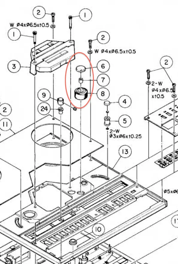

Do you have the collar bearing that sits on top of the roller on the shaft ?
As mentioned roller sits mighty low.Maybe upside down?
Gary
Look at the picture, #7 (collar bearing) should come out when you remove the pinch roller. Do you have it ?

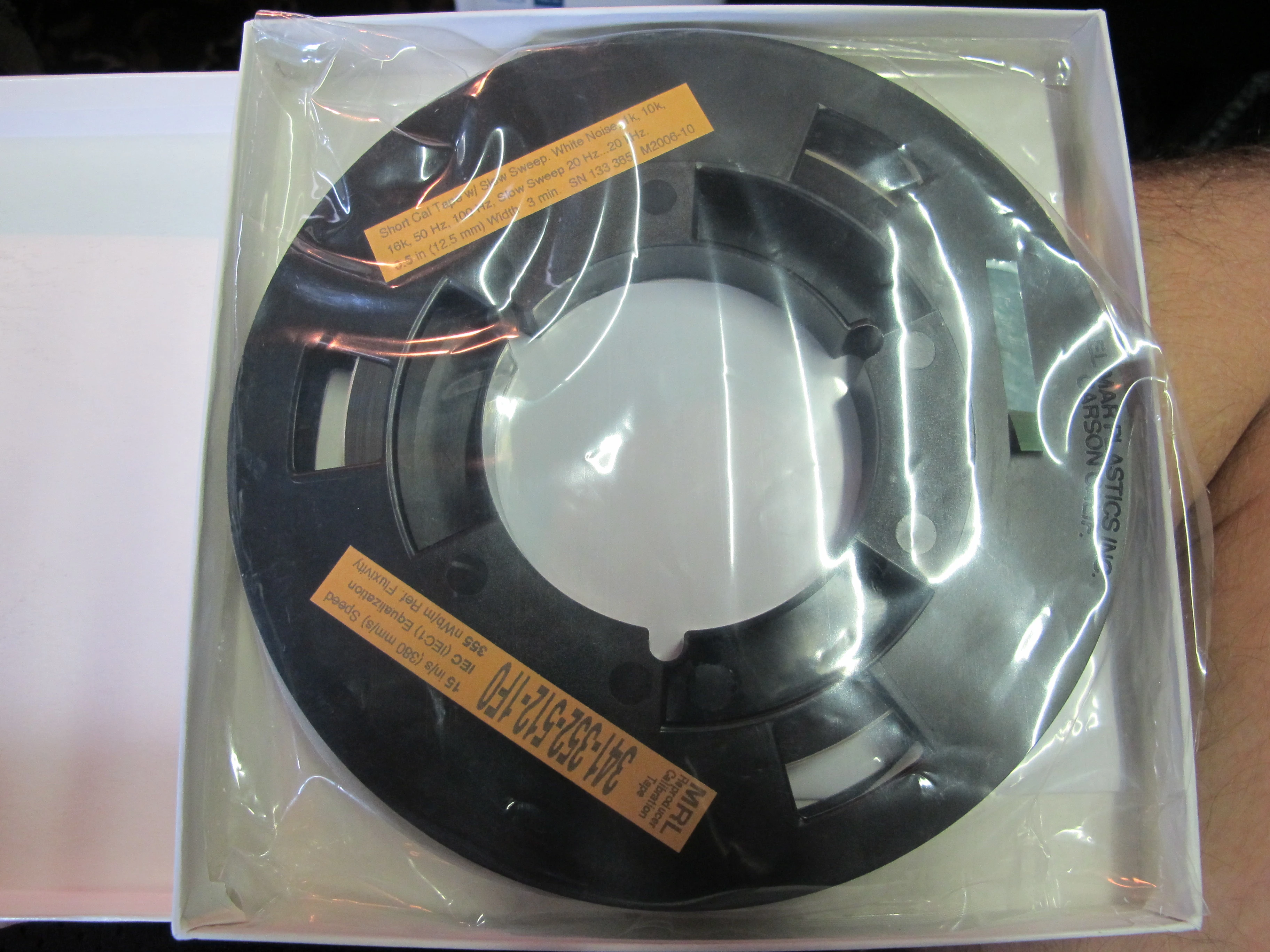

Can you photograph the test tape? I'm curious in case it's got some weird centrepiece like the Zonal tape I have. That one was rather high, but it only rubbed a bit more than usual. It didn't do this.

It pic #1 the tape is to high up on the tape "guide" (see it crinkled?) so that seems to me that the table height needs to be lowered on either the take up side are the supply side are maybe even both...;)
Yeah, it looks like the centrepiece might be pushing it up. Spooling it onto a regular metal reel might be wise. By hand if necessary.
What is centrepiece?
Okay. A normal reel has a completely flat top like this:
Or seen from the side:
Some reels, like the one your test tape has been wound onto, have a central hub as well:
Seen from the side, you can see that the hub protrudes. About 1mm each side on my Zonal reel:
...this can cause problems. Adjusting the height of the reel tables in the deck to compensate is one option, but it's tricky to do and if it's adjusted for funny reels like that, it is very possible that it will no longer work properly with normal reels afterwards.
