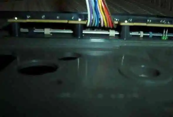

And if there was a case where you broke them it would not be hard to fix as long as you get the part. Its just 4 small screws and a plug and your done once you get the face of the machine off that is. Here is a pic the rod and side of the switches.

First of all, I'm a bit confused as to the point of view on that photo? What exactly am I looking at there?
Other than that, thanks alot for the info, I suppose the person who told me this just had a bad experience with his 38 back in the day. who knows. Then again, he's also a digital nut, so he probably made that up to try and convert me to the dark side. :eek:

Sorry I didnt exsplain about the pic.
That is the rod inside of the machine you said was plastic. I just happen to have the face off of a 34 when you ask the questions about the 38. The 38 and 34 have the same switch assembly.
