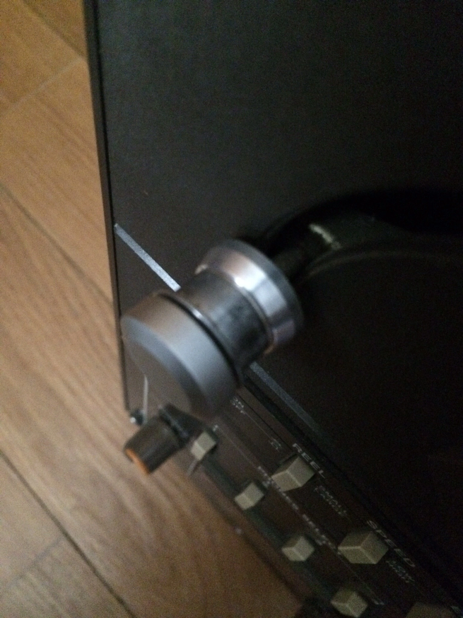

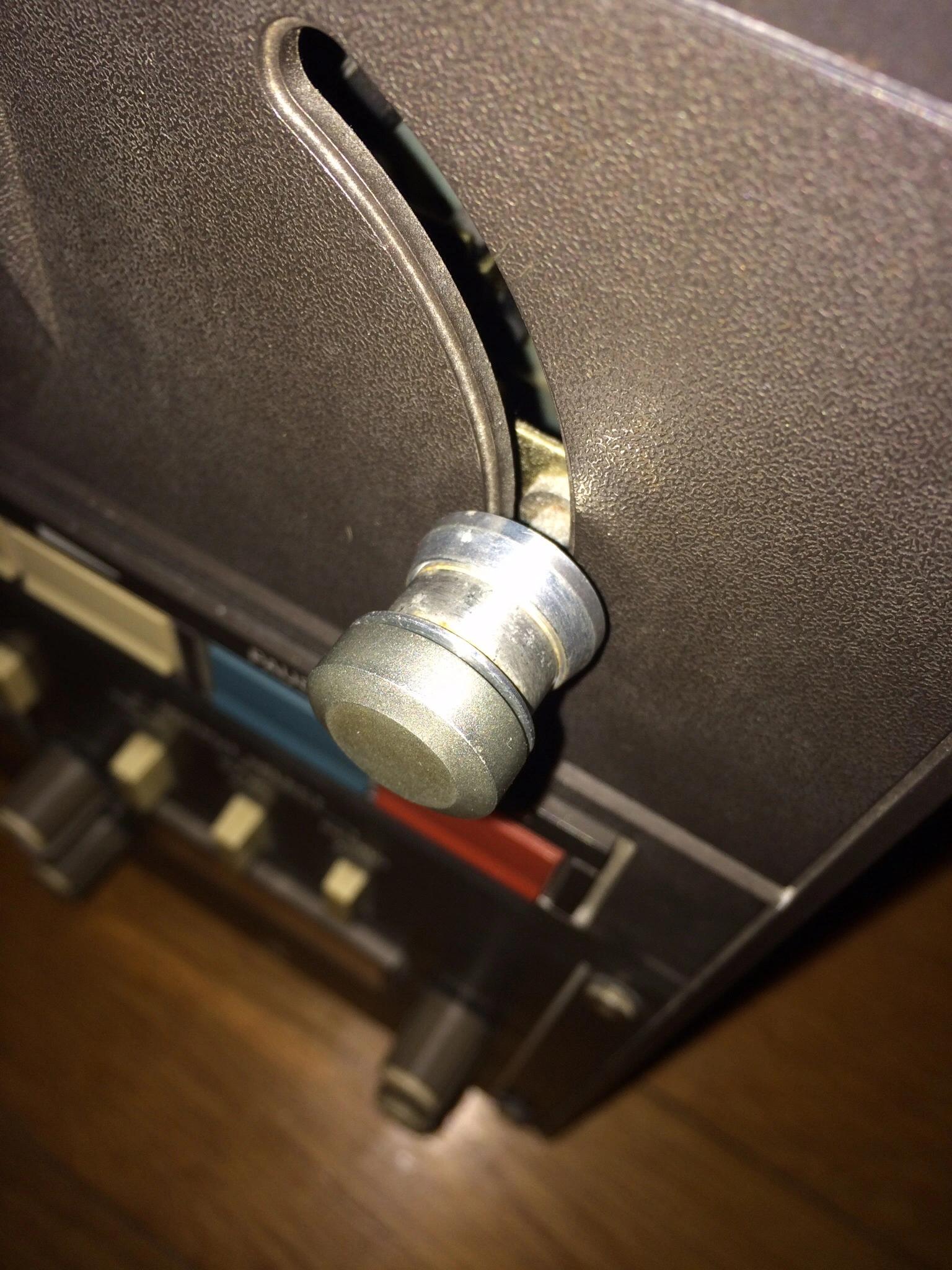

I'm trying to restore a Tascam 34B and one of the problems is tape alignment during fast or rewind at high speed.
While playing, the tape is rolled ok but at high speeds the tape on the reel become misalign and irregular.
What should I do?
Can you point me to a related thread?
I suspect the problem is related with the tape tension rollers.
Carlos

So I can assume that the 0,8 mm gap shown on picture is normal?
Or is it missing some Teflon washes? The tape tensions rollers play a bit back and forward.
There's no exploded assembling graphic on my manual, so I don't know if there's something missing.
On other machines (AKAI) there's no moving parts.:confused:
Carlos
Gap
The gap is a bit excessive. The original washers are steel. There are 2 for each roller, front & back. There is no separate part number for the washers in the 38 manual, but you may have luck getting the part (& part#) from Tascam Parts dept. You may also find the part is 3c and shipping is $7, so you may want to order several.
You may want to find/replace the washers on the tension rollers & it may close the gap a bit, but I'm not sure it will be the silver bullet you're looking for on achieving an even tape pack on fast wind. However, it can't hurt to try. I'm not sure if the washers are there for spacing or to give the roller a bearing surface that isn't the shaft or cap, respectively,... or both.
I've had many Tascam r/r recorders, although only one as factory-new, but I don't recall ever having an even tape pack on fast wind. Hence, I use tail's out on play mode. You may read on other sites that in general fast wind will not give you an even tape pack. I'm sure that's what promoted the innovation of "library wind" mode. That's MO & YMMV.
Is there a link to Tascam parts dept?
Can I replace the steel washers by Teflon ?
Carlos
Tascam Parts: 323-727-4840, IIRC.
I don't see any reason why you couldn't source an OTC petite Teflon washer, as long as it minimizes the gap & doesn't bind.
A little application of fine machine oil or WD40 with a swab on the shaft might be a good idea as well.
:spank::eek:;)
On my 34 there is a Teflon washer above and below the tension roller. As the 34b is an upgraded 34, I think you that they should be fitted on the 34b also (Teflon NOT steel). The specs. I have for the washers on my 34 are; Inside Diameter = 3mm, Outside diameter = 5mm & thickness 0.25mm. You will need two for each roller, one above and one below, the shafts should be slightly lubricated with sewing machine oil or similar. Years ago, TEAC used to do an kit which contained motor oil and spindle oil.
Given that the washers are very small, thin & black in color, I could be mistaken if they're Teflon & not steel. They appear to be metal, but are very thin & somewhat flexible. Most Teflon washers I've ever seen have been white. My factory original 38 still has both washers, front & back on each roller.
The 38 manual has the washers pictured & dimensions (but no separate part#),... however, I was unsure of the nomenclature & was hesitant to quote it. ...(phi)3 x (phi)6 x (tau/t).25 ... so go figure.
