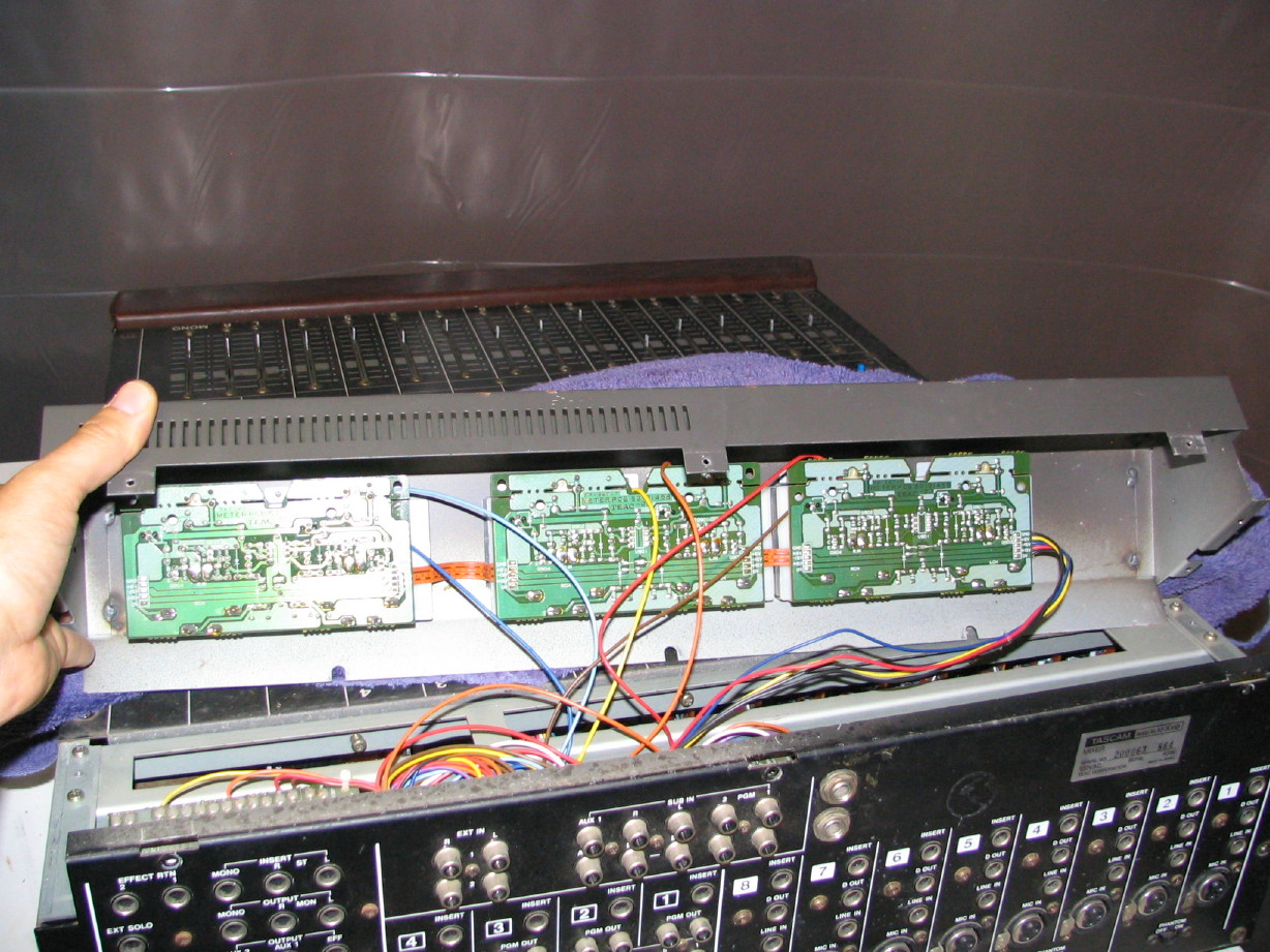

Received 10 lamps from GCalo for under $15 shipped. Many thanks! :)
Old thread, but thanks so much for this great photo tutorial! I just dragged out my dad's old 320B and those VU meters are too valuable to leave in the dark!
It's nice to find this kind of info on forum when the equipment in question predated the internet and is practically invisible online. ??

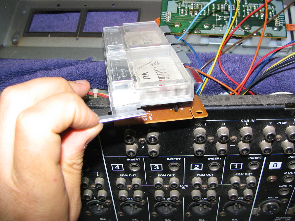

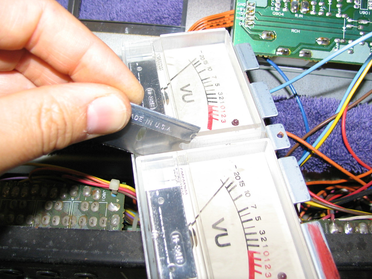

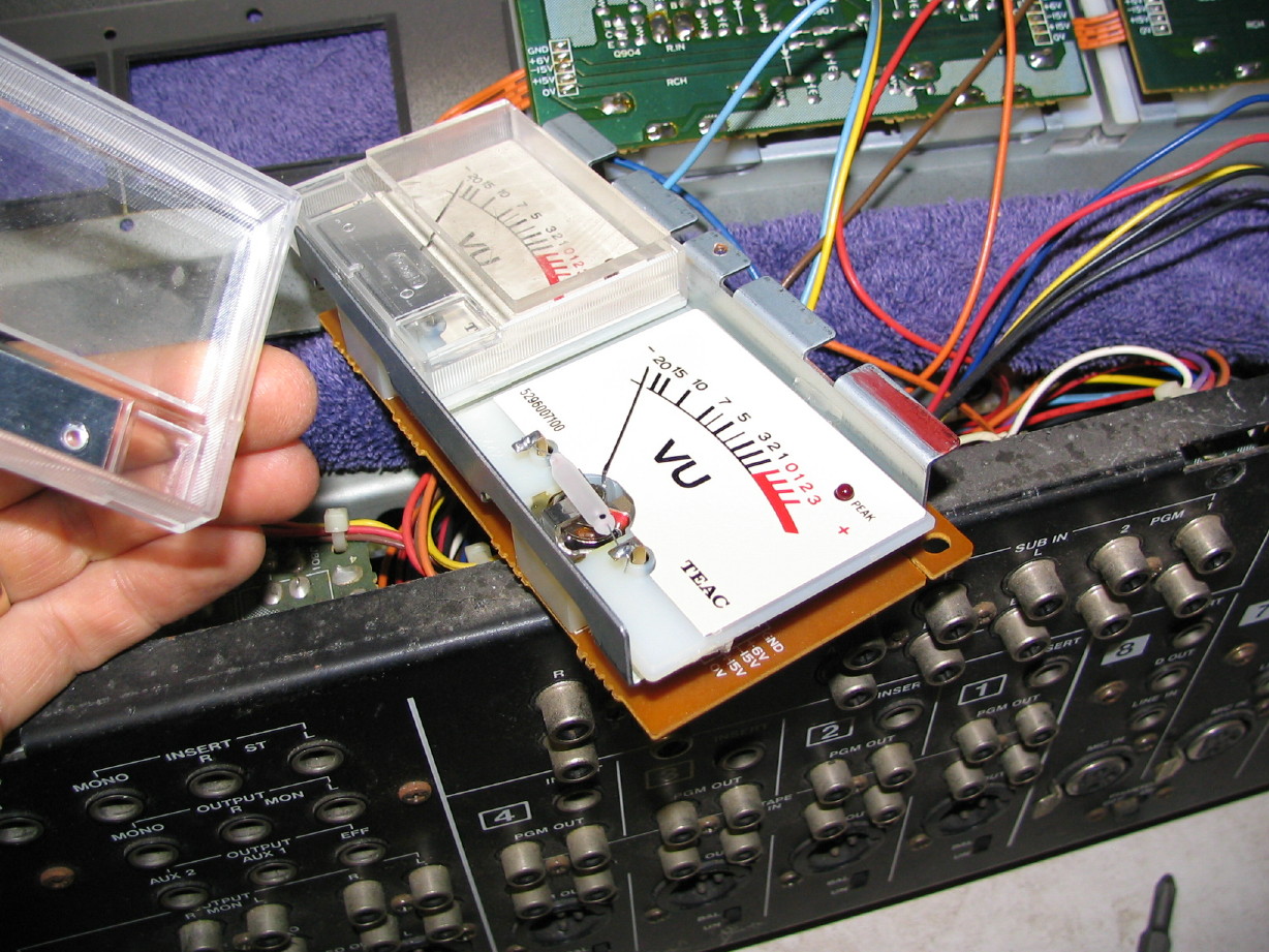

Super easy on an M-500 series console or M-50. There is a panel on the back of the meter bridge affixed with screws. Remove the screws and the panel. You’ll now be able to see and access brackets that fasten pairs of meters to the meter bridge chassis. Remove those screws and you can remove a pair of meters from the bridge. It’s possible…can’t recall from memory…you’ll need to remove multiple pairs of meters to access the 5/6 pair. I can’t recall if they are connectorized or hard wired. Anyway, once you get the 5/6 pair accessible you use a razor blade to slice the clear tape holding the lense to the meter assembly. Don’t do all 4 sides…do 3. Then you can tip the lense of each up and out of the way and you’ll see the lamp soldered in. Assuming you have the replacement lamps, just desolder the old, solder in the new, and reassembly is the reverse of disassembly. Disclaimers abound. Do all this with the device disconnected from the mains power. Proceed at your own risk. I’m not responsible for you zorching yourself or your device. I’m posting all the steps from memory so verify with your service manual and/or other resources.

Note, IIRC the lamp installation on an M-50/M-500 is polarized. The replacement lamps usually have one side either marked with a band or the glass is beaded at one end. Observe the installation of the factory lamps and mirror the installation of the replacement lamps to the factory orientation. Again, this is from memory. I can’t recall if the M50/M-500 series or the M-300 series have a DC power rail for the meter lamp illumination…if it’s AC the lamp orientation doesn’t matter. If it’s DC it matters. Easiest thing to do is, again, observe the orientation of the factory lamps and mirror the installation of the replacements to the factory orientation…and not worry about the power rail spec.
Thank you so much ! Actually, on my console the meter lamps are of the fuse type, they seem to be clipped. I have bought 8 regular lamps (for my Tascam 58 reel to reel) and 8 fuse type lamps.

Ahhh that’s right. I remember now. The fuse lamps. And at the time I couldn’t find replacements that were the same length, so I soldered in leaded lamps. Obviously that’s changed. But the polarity caution remains. On the fuses lamps sometimes there’s a red or black dot at one end or the shape of the metal cap is different on one end, so just mind that in your replacement. I should just pull up the schematic to refresh on whether the lamp power rail is AC or DC on the M-50/M-500 series…I *think* it’s 6V AC. Anyway, where did you source the lamps? I like 1000bulbs.com.
