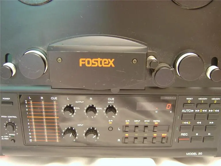

Maybe O/T,...
but I just scoped out the Fostex Model 20, that's similar to the 22-2 in format and size, same # of heads (3), but the Model 20 does indeed have a "Input/Sync/Repro" selector for independent sync/overdubbing to tracks 1 & 2. (Plus center timecode track)!
It makes me happy I got the Fostex Model 20 instead of the Tascam 22-2!! :eek: ;)

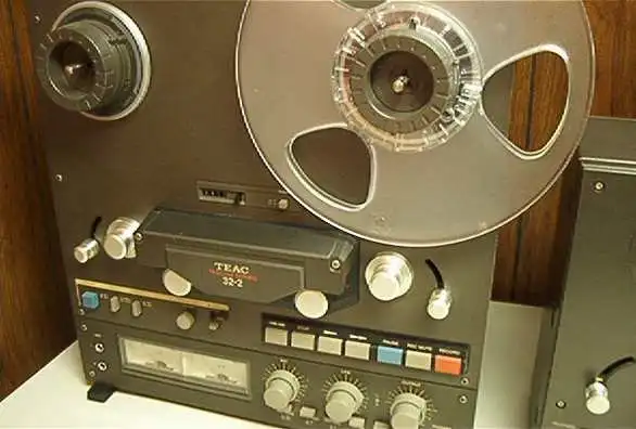

Here is one you dont see alot of the teac 32-2 And it is a 1/2 track also.
But it wont let you even do seperate tracks like the tascam 22-2 will.
And it wont do sync either.
Note the dual capstans!

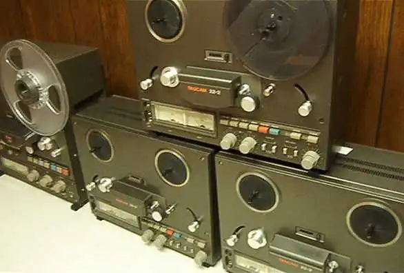

Come on Dave you know its eating at you that you dont have a 22-2 in your collection :D
