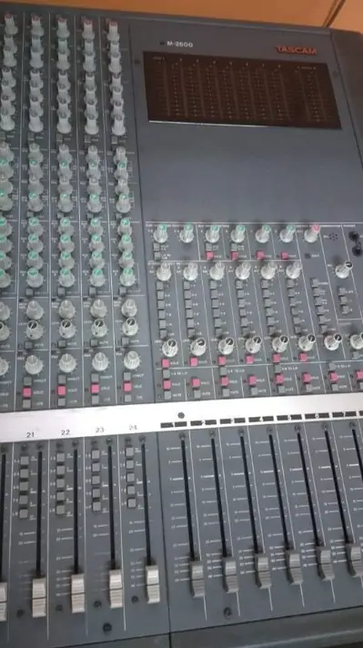

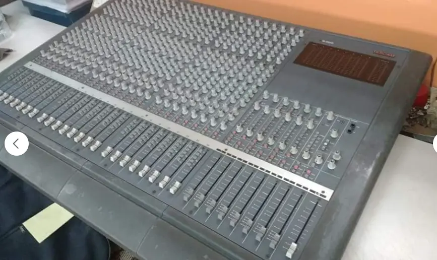

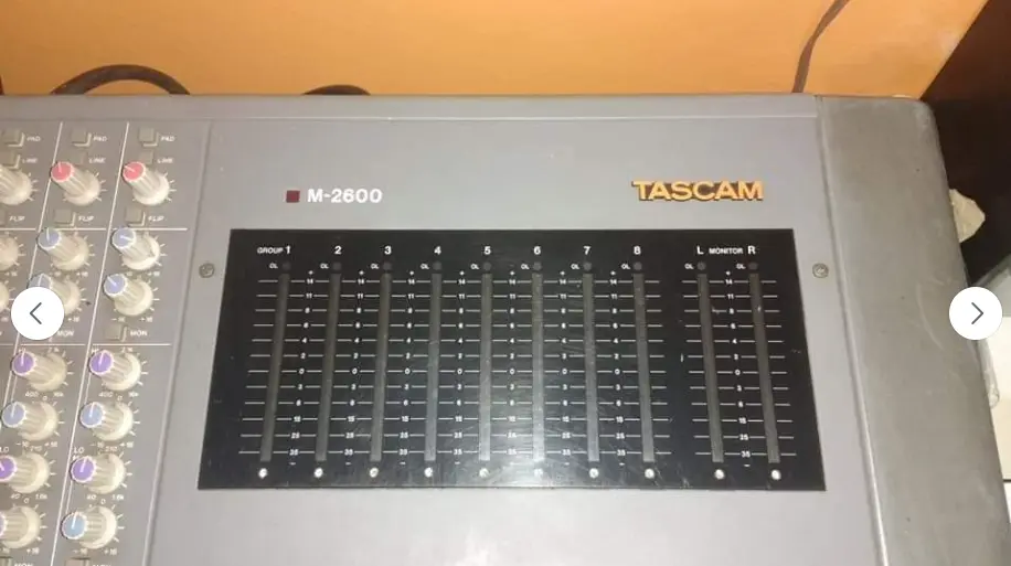

Hey everyone, hope you're all doing well.
I've got a bit of a dilemma... I have the opportunity to purchase a used 1994 Tascam M2600. It's being sold by the original owner who mentioned they need to free up some space in their house and no longer use it. From what I understand, he is an older gentleman who simply isn't utilizing it anymore and wants to part ways with it. He is asking for $300 for the console.
Truth be told, I'm not too familiar with this type of console and would appreciate to hear your thoughts. Currently, I own a Tascam 48 OB, and I'm wondering they might complement each other well. My current desk is an A&H Zed 420.
Any insights or experiences you could share would be greatly appreciated!
Thanks in advance.

I have the 32 input version of this board. My only complaint is with the so-so performance of the mic preamps. They're quiet enough but are rather "soft sounding" due to poor transient response. Because of this, I use my outboard units for everything.

Hi. So your Allen & Heath console is a fine console…pretty stright-forward feature set, can support your 48-OB well and has the advantage of the 2 x 2 USB interface if you need that sort of thing, the matrix mixer can be handy for several things…that being said the price on the M-2600 is a good price, particularly if it is clean and complete, one-owner etc. The big caveat with the M-2600 is it’s significantly older than your Allen & Heath and so there may be more maintenance issues to address or eventual recapping to do. It obviously also takes up more space. But those things being said, the Allen & Heath is more focused on live FOH applications in its feature set, and the Tascam much more “dual-purpose”…even better suited for recording environments. It has more input channels, it’s an 8-buss console, has better metering, split EQ assignable to the monitor buss…and it has a monitor buss…and more AUX busses…dual purpose input strips with the “FLIP” function for tape returns on mix down, a more comprehensive master and monitor section, the 6 assignable stereo effects returns are nice…I could go on. It’s a much more feature-rich console than your Allen & Heath, and if you put both in front of me and asked which I wanted to go with my 8-track machine I’d grab the Tascam in less than a second. On a more geek level the Tascam is all through-hole PCB construction vs SMT on the Allen & Heath. I care about that because that makes it easier to service/repair when needed. The Tascam has an external power supply which moves a potential source of noise interference away from the console. The M-2600 uses an interesting array of opamps that are less common and were high quality in their day…still good IMO: 5220, 4741, 15532. This can be good and bad in that they may be harder to find if replacement is needed, though there are likely drop-in replacement alternatives, *except* they used SIP packages throughout the console (except for the 4741 chips which are DIP-14) instead of DIP…at least it’s SIP-8 instead of SIP-9 like on the MX-80 rack-mount mic amp/mixer. What’s really interesting to me is the audio power rails are +/-20V, significantly higher than the typical +/-15V or sometimes +/-17V…higher headroom, though also may shorten the life of some active components like the 4741 which has a rated input power range maximum of +/-20V…but I’m not aware of any common issue regarding failures of these parts in M-2600 series consoles.
SO…hope that helps.
Thank you so much for your comprehensive insights! I really appreciate the detailed comparison between the Allen & Heath console and the Tascam M-2600. Your breakdown of the features and potential maintenance considerations has given me a much clearer understanding of both options.
It's evident that the Tascam M-2600 offers a more extensive feature set, particularly suited for recording environments with its additional input channels, busses, and comprehensive master and monitor sections. Your point about the through-hole PCB construction and external power supply also highlights important factors to consider regarding servicing and noise interference.

Yes the M-2600 series features phantom power.
The M-1500 and M-2500 series consoles were introduced in 1991, while the M-2600 series was introduced in 1994.
The M-1500 and M-2500 series consoles are neat, but the M-2600 series is a significant upgrade to an M-1500 console…to name a few points, the M-2600 consoles have a superior EQ section, more AUX busses, 8 summing busses…more of everything…and I can’t verify this but I believe the power rails are similar to the M-2500 on the M-1500…the M-2500 is surprisingly low at +/-12V…lower headroom than average…the M-2600 has +/-19.5V audio rails, which is considerably more than the average and therefor me higher headroom…higher quality opamps in the M-2600…but it’s also bigger and heavier, etc.

I use an M-2600 MkII more or less weekly, and have been doing so since the late 90s. If you find a scan of the manual, there's a good chance it's the one I made.
The phantom is in banks of eight channels.
The switches on the one I use benefit from regular exercise, as do the pan pots. That has cleared up some signal dropouts. Otherwise, it works fine.
