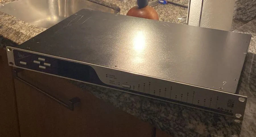

As for the Apogee, I have the x16 DA and x16 AD models (photo attached of the AD. Unfortunately, I couldn't find information on their manufacturing year. Concerning the connection with my Apollo x4 via ADAT, are you suggesting there could be potential issues in compatibility?
No issues - just that the Apogee Convertors are quite as good as the newer Apollo convertors.
Apollo x4: "Digital: 8 Inputs / 8 Outputs at 48 kHz"
Its possible to connect both convertors via ADAT to the x4?
Case positive, I understand that I can only use 8 out of the 16 channels. I would like to have access to all 16 channels, mainly for mixing. What would be necessary to incorporate in this case? Another interface and connect it via thunderbolt 3 to the x4?
Should I sell the x4 and buy another interface that comes with more features to be able to use the 16 channels of each the converters?
I appreciate your insights.
ADAT only allows up to 8 inputs and outputs per pair of optical ports and so yes, to run 16 I/Os you would need another Apollo 4x interface and, AFAICT that would be possible with TB. However, that means duplicating many functions that you may not need and so it might be operationally better to get an interface with two sets of ADAT ports?
