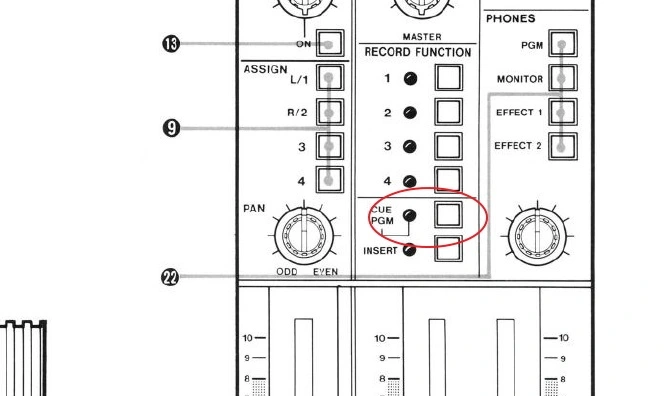

My issue isn't necessarily hearing reverb while recording (whether printing or not) ... it's hearing tape tracks through the monitor buss along with FX returns or sub-ins --- all out of the MON jacks or phones.
For example, I'm wanting to start recording a song with a FSK stripe on track 4, using EZdrummer on my computer. I've got the syncing working great, and the computer is chasing the code perfectly. So now to route that signal to the 246.
I can have the outputs of my computer (EZdrummer) plugged into either channels 5 & 6 (normal or Line B) or the PGM BUSS ins of the 246. If they're going to CH 5 and 6, I can just, as you said, route them to BUSS 3/4, for example, leaving 1 and 2 open for recording.
If I press the PGM/CUE button (see picture), I'm monitoring the PGM material out of the MON jacks, and so I can hear the EZdrummer part perfectly. But I can't hear the tracks off the tape like this, because I'm not monitoring the CUE mix.
If I'm listening through the 246's MON jacks and press play on the 246, for example, and have the EZ drummer playing along (sent to CH 5 and 6 and assigned to BUSS 3/4, for instance), I can hear the tape tracks when the PGM/CUE switch is up (not lit, CUE). I can hear the EZ drummer part when the switch is down (lit, PGM), but I can't hear both at the same time.
Is there a way to do this?
And this kind of circles back to my original question. I want to be able to hear a signal (whatever: FX return, EZDrummer part from the CPU, etc.) that's routed to CH 5/6 or one of the PGM BUSS ins along with tracks on the tape while listening through the MON jacks or the phones.
If there's a way to do this, I haven't found it yet. The only way I've been able to hear both sources (the tape and the aux signals) simultaneously is by putting the tape tracks in RMX and then monitoring off the PGM buss.

i dont know if I fully understand it, but you should be able to hear the channels with input selected as rmx plus the other two aux channels... or not? just tying to help....
Thanks for the reply. If I'm understanding you correctly, then yes you're right.
If I have, say, a guitar part recorded on track 1, I can put that track/CH into RMX, assign it to BUSSes 1 and 2 and pan it to taste, and push the PGM/CUE button so that it's lit (PGM is selected). This will allow me to hear what's recorded on track 1 along with what's coming in from the aux source, which could be an FX return or EZdrummer from the computer, etc.
However, this means that I can't record anymore without bleed because all of my busses are being used by something. In other words, if I try to record on TRK 2, for example, the guitar part (from TRK 1) will be on there to some degree (unless it's panned hard left) because it's assigned to busses 1 and 2. If I try to record on TRK 3, then the aux source will be on there because it's assigned to busses 3 and 4.
So I'm trying to find a way to be able to hear the aux signal (FX return) while listening to the tracks off tape in the cue (monitor) mix.

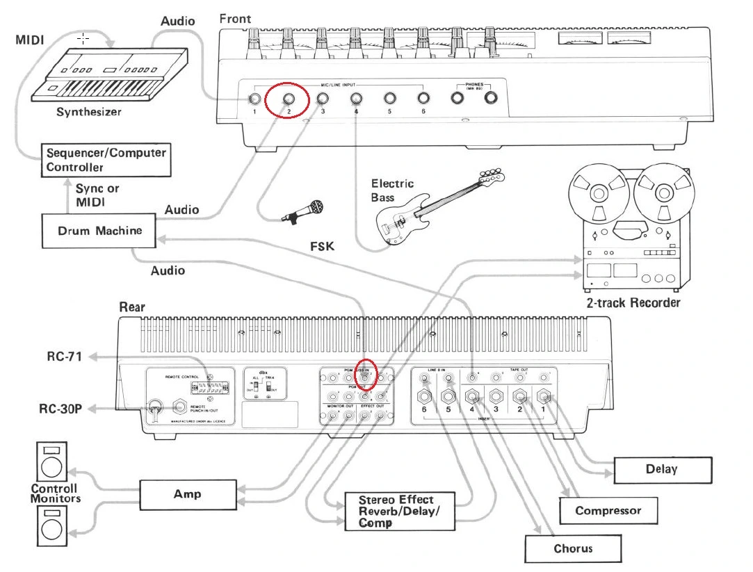

Thanks for the info Cory. My head is still swimming a bit right now trying to figure all this stuff out.
I guess I figured that, since the manual tells you to monitor off the cue mix during all the basic tracking (I'm assuming it does this to free up the inputs for recording with all six channels if needed?), and there's this diagram showing how to hook up an "Electronic Music Studio" involving a drum machine chasing tape (see picture), then there should be some way to do it.
You can see in the diagram that the audio output of the drum machine is routed to either input 2 or PGM buss 2 (I'm guessing this is and either/or thing --- I don't know why it would be sent to both). This diagram is basically what I want to do, but I can't figure out how to hear the drums (EZdrummer in my case) and the tracks off the tape at the same time.
What am I missing?

You want to monitor ez drummer in stereo?
How many tracks are full and which do you want to monitor?
What are you wanting to record and to what track(s) while you are monitoring ez drummer and tape tracks.
Be specific. I'll try and help. But I've never even seen a 246 in person.

Thanks Cory, but I think you've already answered my question by assuring me that there's not a way to do what I was originally asking. I think I can probably find workarounds to do it, but like I said, from looking in the manual, I thought I wouldn't need a workaround.
Thanks again! :)
