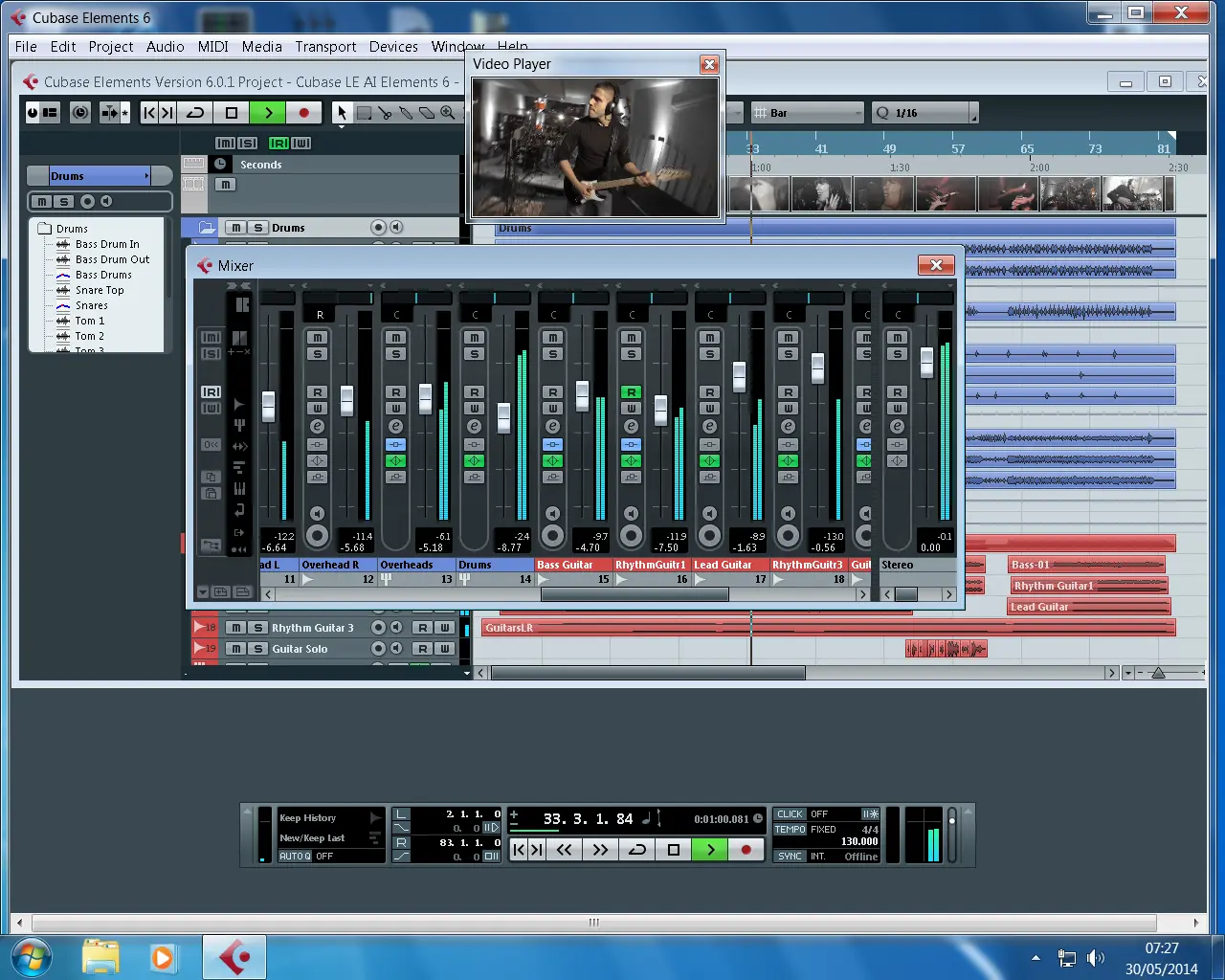

Cubase, at least none of the versions I have, does not show dB levels by default and I am blowed if I can find them IF they are there! (I have up to Cubase LE6) .
Another problem I have is that I have never been able to get a meter to show the INPUT signal when recording apart from that silly thing dinking about in the transport box. But the OP can see the relationship twixt track levels and final mix if he puts up the "Live Forever" demo song and selects the mixer (still no decibabbles!).

No, there are dBFS meters on all tracks and in mixer in all versions of Cubase. dB meters? Not sure why that would matter in a DAW. No input channels on LE versions of Cubase. Only the full version. Full Cubase 7 also has RMS and whatever that other thing is called that I could care less about. lol. Not sure what Dave is talking about here...
I'm assuming Dave meant dB(FS) meters in his post. If not, them I'm confused to.
Just having "dB" without SOMETHING following it is actually meaningless, though all to often some of us (and I'm as guilty as anyone) leave it to context to guess whether we mean dB(FS) or dB(SPL) or even dB(W) if you're transmitting to a satellite!
Oh! It is ENTIRELY possible that this V old, med ridden brain has Cubase all way wrong till Christmas but this is how I find it?
The screen grabs show the Cubase demo song. No dBFS markings and I know of no way to get them to show.

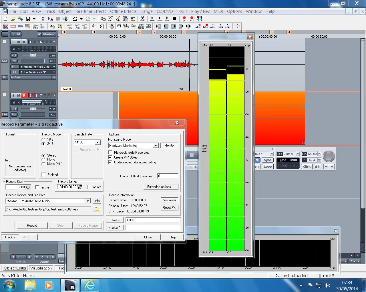

By contrast see the grab of the "free" Samplitude SE8 included in Computer Music magazine (other Samps' have meters but none as good as SE8 IMHO) See that not only are the meters dB scaled but you get a rolling numerical output value of both the peak and rms value.
Note too that the SE8 grab shows the INPUT signal to the DAW. As I said, I have never been able to do that in any Cubase I have had. IF input meters are only available on the full fat version that is pretty shitty of Steinberg in my view. Fork! Even the totally free Audacity has in and out meters!
