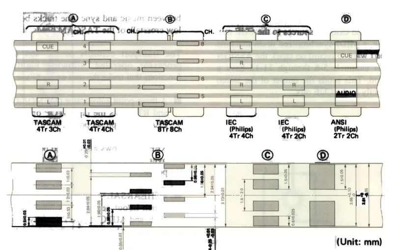

Thanks guys, I just thought this machine may have been some sort of oddity, not really useful for what most of the people do here. It would have made more sense to me if the 3rd time code track were actually on the 4th track of the tape, to prevent crosstalk and bleed between the tracks.

It would have made more sense to me if the 3rd time code track were actually on the 4th track of the tape, to prevent crosstalk and bleed between the tracks. -MD
I'd have to double check the manuals on that, so it may actually be the case. Good thinking.
I just wanted to emphasize that the timecode track on the 133 is not a "center-timecode" track, like on many reel/reels, but it occupies an entire legitimate track, which is quite a difference.
It may actually be on the 4th physical track, so I'll check that info again, sometime soon.

I've checked the 464 manual, and MadDog is right,... that the 3rd timecode track actually occupies physical track #4, with track #3 as a guard band. My mistake, above!
Nice catch!
See: ;)
