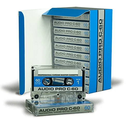

I've been trying out cassette brands that are still available, if you want something you can buy a rather large stock of, National Audio Company has BASF 771 tape that I really like. They say a minimum order of 80 cassettes, but if you contact them directly I'm sure they'd let you purchase a small amount to try out.
