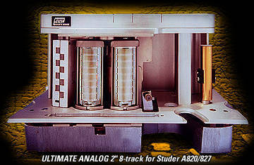

Also keep in mind that 2" 8 track is only going to do a better job of capturing the information. If the information sounds like garbage, your (not you specifically) garbage will come through with arguably more clarity and accuracy. I'm picturing a JRF Ultimate Analog deck with a Behringer mixer in front of it...please, no Behringer bashing...not trying to go there and I often think its unwarranted anyway, but the picture is like trying to run a top-fuel dragster on regular unleaded...
