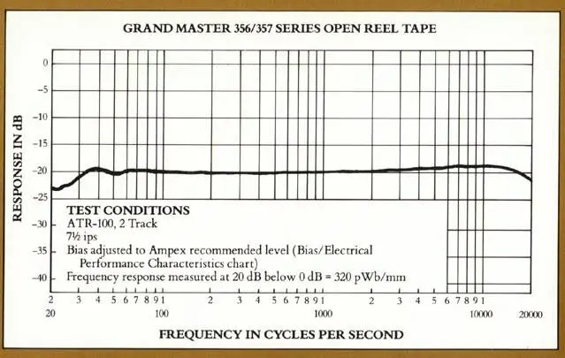

This is from the back of a box of Ampex GM-1800 (357), so you won't have to wonder "Does anyone really know?" ;)

This should clear things up…
I posted the photo from the box of 357 because the question has come up now and again whether 357 is a typo or is an actual tape. The answer is… it’s a real Ampex tape model number that was discontinued before our time (my time, anyway).

Ampex 357 appears to be very close to Ampex 457, but not exactly. Coercivity is very close on 357, 407 and 457 (305, 330, and 320 Oe respectively.) 357 Retentivity is 100 points down from 457, but 100 points higher than 407. Frequency sensitivity @ 1 kHz and 10 kHz are a bit less for 357 than 457, but not much. I've always thought of 357 as on par with 407, but maybe it's technically in between 407 and 457 (making it completely unnecessary… probably why they don’t make it anymore).
I would characterize modern 457 as a new and improved 357, or just a better cut (closer to the center) in the manufacturing process.
The most important thing to know is that all these tapes are bias compatible as demonstrated by the coercivity figures above. Ampex/Quantegy 406, 407, 456 and 457 all require the same bias, as do BASF 911 and 3M 206, 207, 226 and 227… you get the idea. BASF 911 has a coercivity of 320 Oe, same as 456/457. BASF LPR-35 is 320 as well and fits into the same niche as 407/457 as a 1-mil tape for use on machines like the R8, 388 and 22-2.
