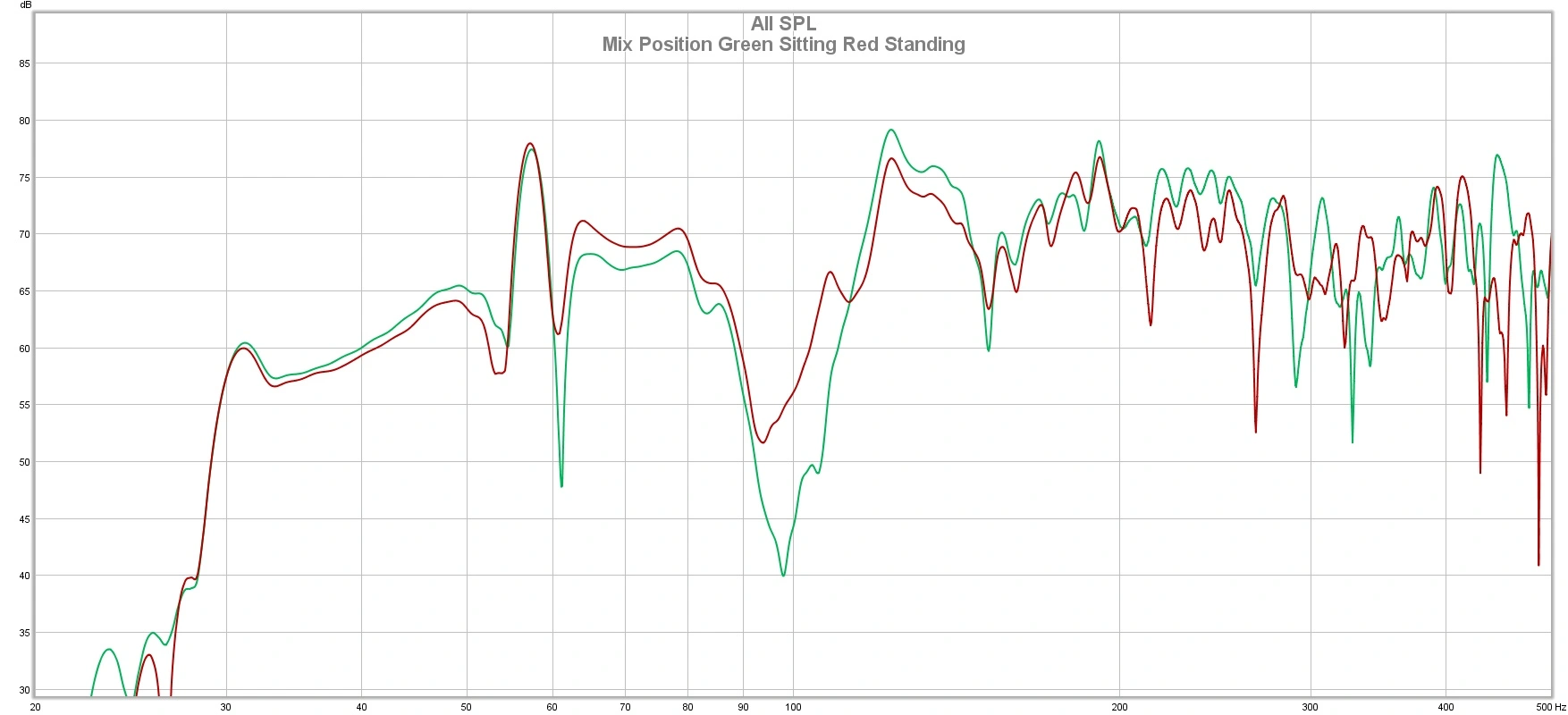

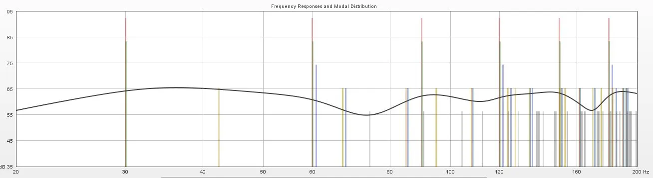

Now you'd expect that lot to make a big difference, but it really hasn't because of the shape of the room. I have a massive null around 100hz.
Its so bad if I walk to the centre of the room and bend down so my head is around 4 ft from the ground it completely cancels out.

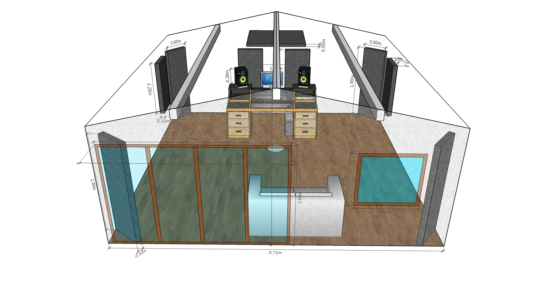

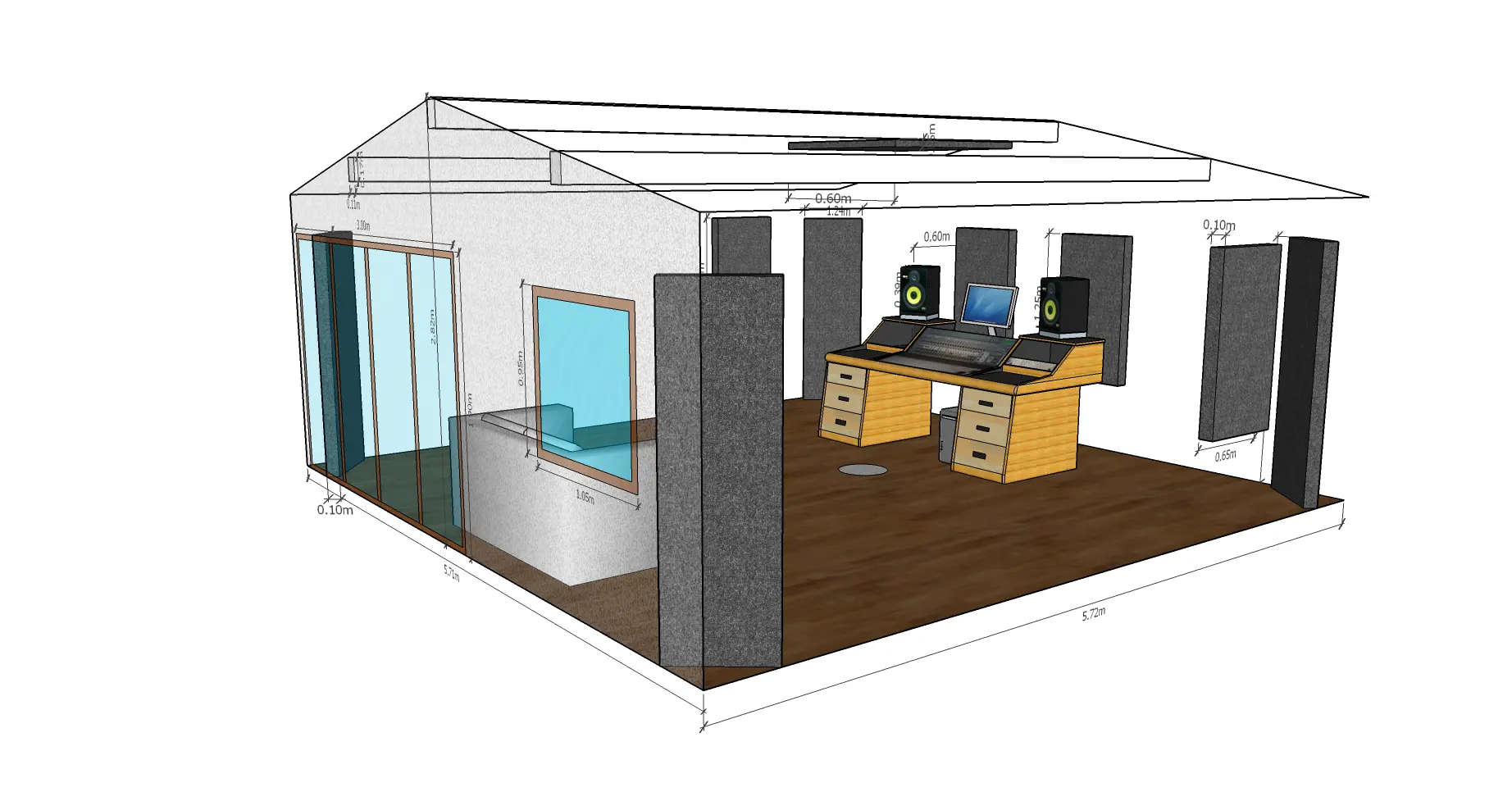

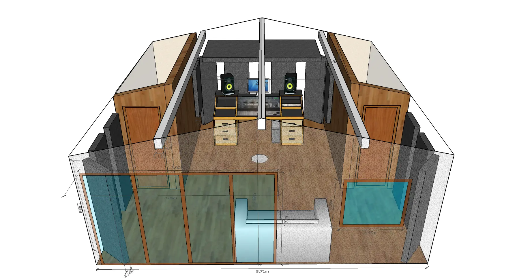

I've just finished putting together a plan in sketchup that is to scale and I've tried to get the measurements to within a few millimetres of where I have things positioned.

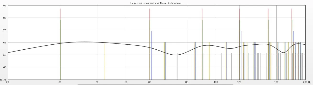

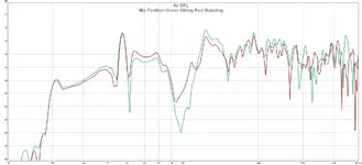

I've also posted my REW results. the measurements were taken in the mix position, one sitting and one standing.

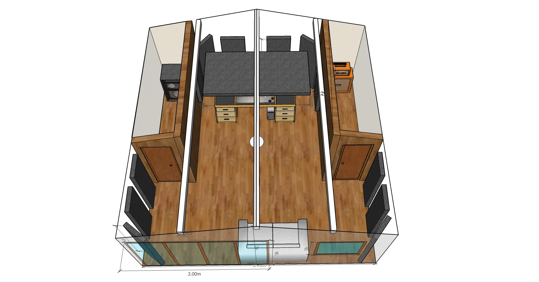

The big question is... Even if I spend thousands on trapping will I ever get this space sounding good, or do I need to go back to the drawing board - Actually, I did play around in sketchup and wondered if it would be cheaper and more effective to just add a couple of stud walls to improve the room ratio. Png's below:
Any thoughts or better ideas than mine would be great,
