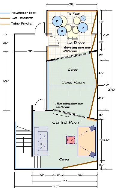

here's my contribution
Try this layout enigmacode :)
cheers
John

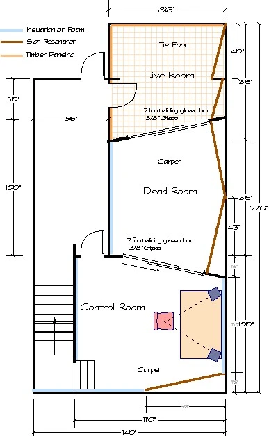

Try this instead - it has more dimensions and a bit more colour :):)
BTW everything is in scale!!
cheers
John

WHAT A GUY!
Hey Thanx a lot John!
I've been examining ALL your drawings including
'atomictoyz Junior Member's too.......
Well now how much patience or time do you have for me? haha
I've got some specific questions for ya in regard to your SUPERB drawings......

(In regard to question 4), your colorful update illustrated where the drum kit would go. And I guess if the room is 'TOO LIVE', then of course you can add padding absorbers, where needed?
AND I THANK YOU MY FRIEND! ........
