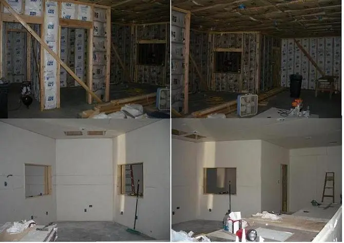

Here is the latest pics of the studio.
It has been a while since I last posted. It takes forever to get anywhere working a day job and gigging and building in the evenings.
I have the studio insulated and the first layer of sheetrock up. I am taping and bedding this weekend, and will start the second layer of drywall Monday.
It is going to be nice to have about 850 sq/ft of room with a/c and a bathroom!
These are pics of just the main tracking / mix room. The drum room is off to the left and the vocal booth and bath room is off to the right. Behind the mis position is an airconditioned machine room for the computer and power amps.
Just happy to show off the progress!
Tom

Beau-ti-ful! I love the dual view into the control room.
Will there be a sight line from booth to booth once the desk and monitors and so forth are in?
-very cool-
Yes!
The monitors sit far enough back where you can see from booth to booth and into the main area as well!
I hope it works well. The thickest glass I could find (within my budget) was 3/8ths glass so each window will have 2 panes of that.
It is bound to be soooo much better than what I am used to anyway!
Well... Miles and miles to go....
Sheetrocking and finishing anyway!
Tom

I hope so. So many bands I have recorded really prefer being all in the same room , or at least have good line of sight, rather then just syching over headphones.
I had toyed with the idea having more (smaller) rooms including a small control room. But it did not seem appealing to run through a labyrinth of doors and openings to make adjustments and then get evryone together for listening sessions. I have gotten so used to working in the same room with everyone, I decided to build a few iso booths but leave the bulk of the room in the main room / mix room. It is about 31 feet by 14 feet for the bulk of it plus an additional 7 by 7 cove for the mix area.
I am reeeealy looking forward to using it. Now I am just having to be patient and not do any short cuts in building and finishing.

I have the second layer of drywall on the ceilings and am starting the second layer on the walls. It does not look much different. I may try to take shots from inside the iso booths. As soon as the doors come in and I can install them I will let you know. I am getting doors made at Lowes. They are solid core with no doorknob holes. I am putting magnetic latches (the kind that are used in some cabinets but bigger) and weatherstripping on them and big dummy handles and push plates to shove against.
I'll post asap.
