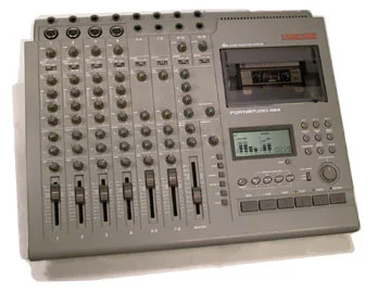

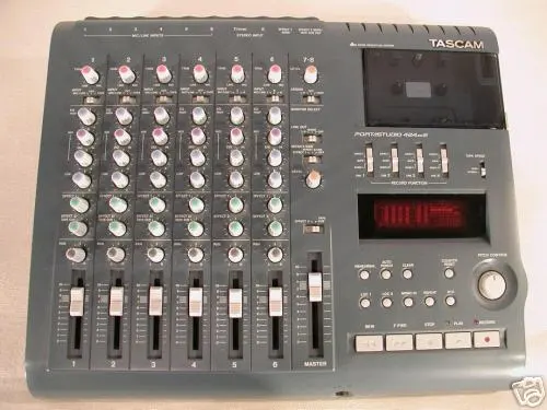

The 424mkIII was the newest and highest-end Tascam Portastudio, but has recently gone out of production and off the retailer's shelves. It's now an Ebay-only item. You may get the 424mkIII off Ebay on many days for $100-$150, depending on the day, and it's well worth it. Many of the Ebay'ed 424mkIII's are still like new with little or no useage. The 424mkIII has all of the best features, including 6-full channel strips, 4-XLR inputs, 3-band EQ, High and Normal tape speed and dbx NR. There's another 2 "raw" inputs for efx returns. It's a very nice package, that's well worth getting at today's Ebay prices. Sound quality and production value is excellent.

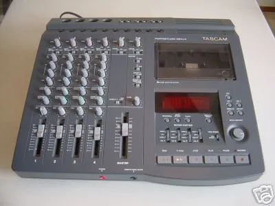

The 424mkII is the previous generation of the highest end unit. It has 4-full channel strips with XLR's and 3-band EQ, but is otherwise comparable in features to the 424mkIII. The 424mkII offers good features & excellent sound quality and production value. Ebay cost on this item is appx $85-$125 on most days. (If you like the 424mkII, you may also want to check out the 488mkII, a cassette based 8-track Portastudio).

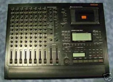

There's the Tascam 644, which is another level of high tech altogether. It features a full 8-channels with 3-band EQ, plus (mixer) dual-function that handles up to 16 inputs, total. There are only 2-XLR mic inputs on the last 2-channels. The tape speed is Normal/High, and dbx NR is standard. There is a Midi-Tape-Synchronizer section that's built into this unit, for those sequencer and MIDI-inclined home recordists. There's also an electronic LCD menu routing and switching section, that enables an 8x4 assign matrix, and is way more high tech than any of the other 4-track Portastudios. (The 644 is comparable in features to the 688, which is another cassette based 8-track Portastudio).

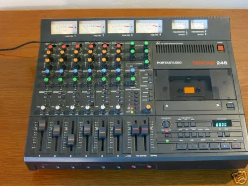

There's the vintage '85 Tascam 246, which is the pinnacle of the VU-meter style designed Portastudios. It sports 6-full channel strips with 2-band sweepable EQ, a 4-buss assign matrix, which is a cut above all the other 4-track Portastudios, with exception of the 644. The 246 has the requisite High/Normal tape speeds and dbx NR. The cue monitor is stereo. There are handy return-to-zero and loop functions that are handy. The only modern feature that the 246 lacks is XLR inputs, with the 6-main inputs being 1/4" phone jacks. Otherwise, the 246 is a topnotch package, almost second to none. Sound quality and production value is excellent. The 246 goes on Ebay anywhere from $125~$175 or more, depending on the day. This one is highly recommended.

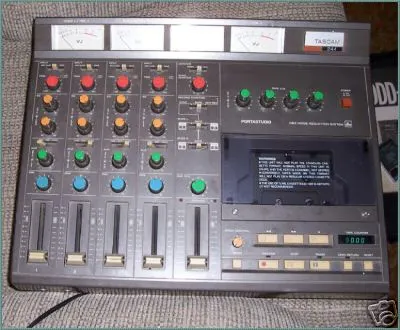

There's the more vintage but still worthy Tascam 244. It's a bit more stripped than the 246, but is still highly capable, and is feature loaded as compared to the likes of the Porta 02mkII or MF-P01. The 244 has High speed, dbx NR, 4-full channel strips with 2-band sweepable EQ, and 4-inputs on 1/4" phone jacks. Access Snd/Rcv patch points and a stereo aux buss gives ample I/O for effects patching. The 244 has a stereo cue buss as well. Sound quality and production value on the 244 is excellent.

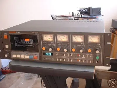

If you have a mixer that you're already very happy with, I'd suggest looking into the Tascam 234 Syncaset. It's a 4-track cassette recorder with RCA and 1/4" inputs, to accommodate either a mixer-input or mic-inputs. High speed and dbx NR is standard. There is a basic cue/monitor mixer onboard that's in stereo. There's some handy return-to-zero and loop functions that are comparable to the 246 (and 388). This a 3U sized rackmount recorder in the VU-meter styling of the 244/246, that's a very highly regarded recorder in it's own right. Sound quality and production value on the 2345 is excellent. You'll see the 234 on Ebay for about $100-$200, depending on the day.

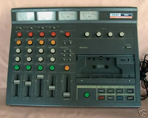

Here's where the subject of cassette 4-track Portastudio recording started,...
the Tascam 144!
Yo! Hey, 1979! :eek:
Followed by the...
Tascam 244!
Hello, 1982 calling!

I love 1985!
Tascam 246;)

Geez,... in 1991, Tascam was rollin' out the high techiest 4-track Porta of all!
Tascam 644;)

Hello 1997!
Tascam 424mkII

We talkin' about Y2K, here?
424mkIII;)
Aaaaawwww!
The Tascam 234!;)
SWEET!
