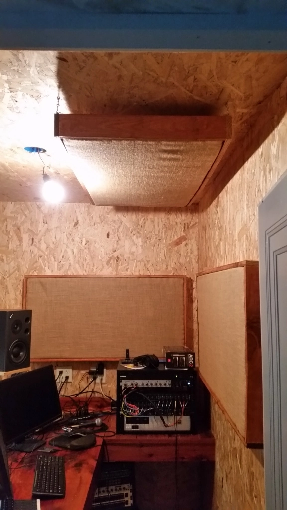

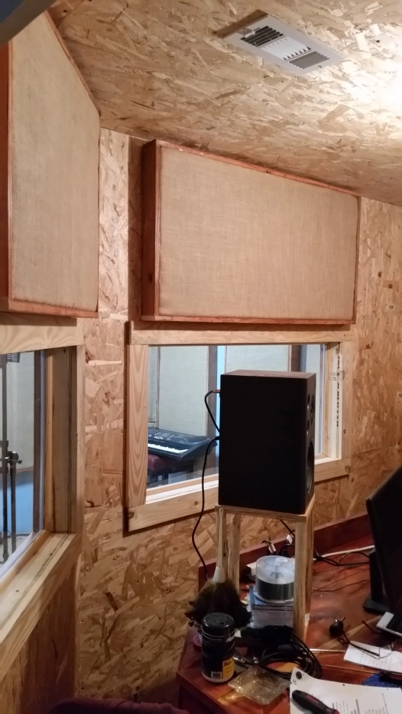

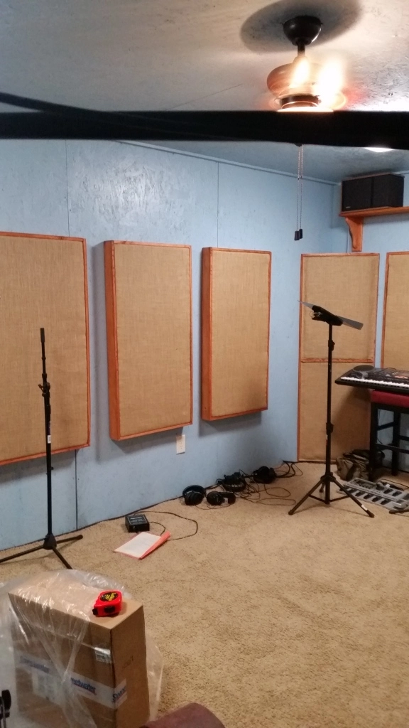

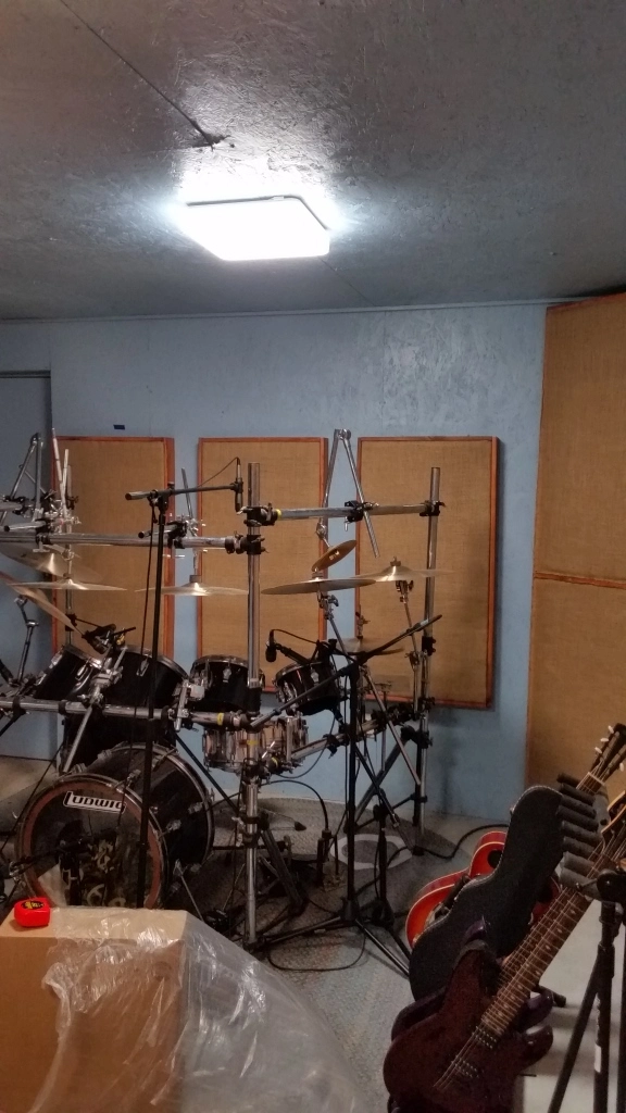

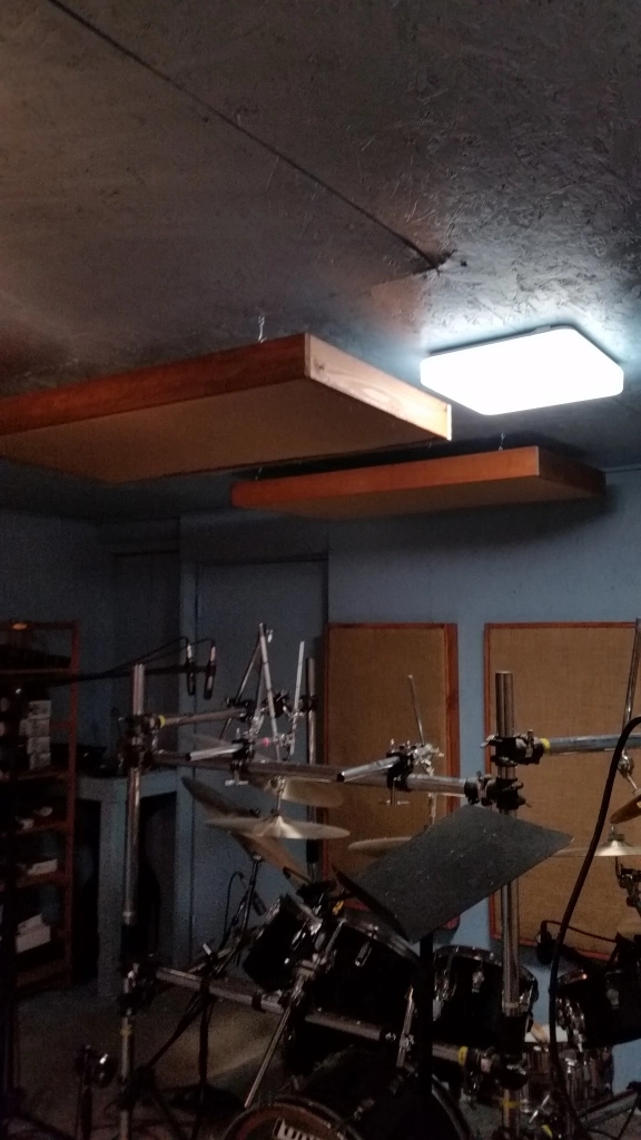

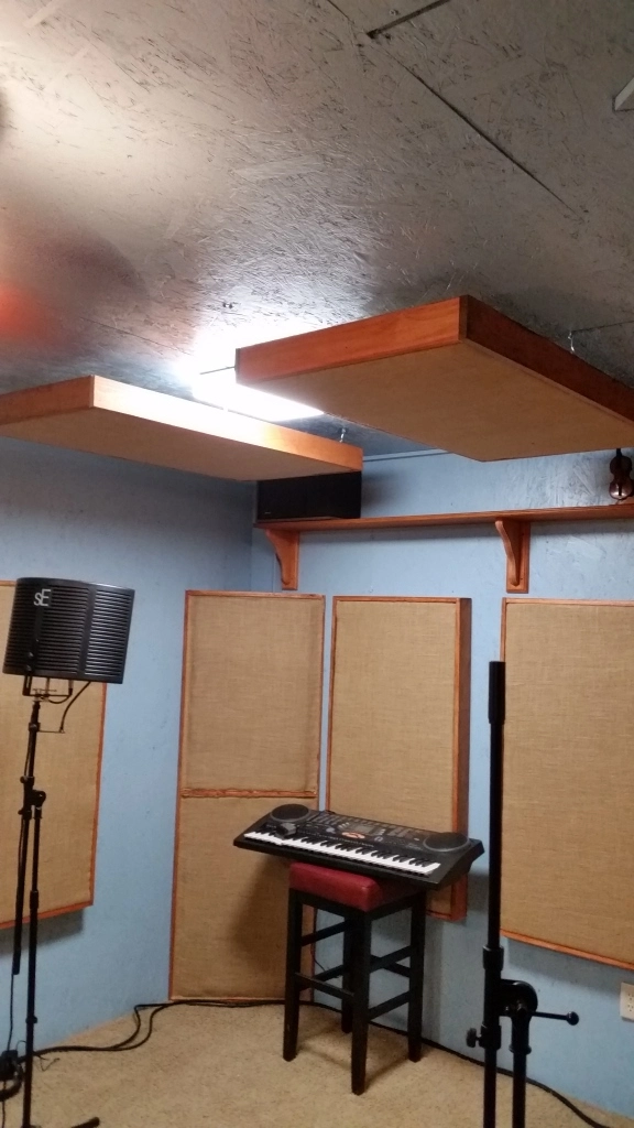

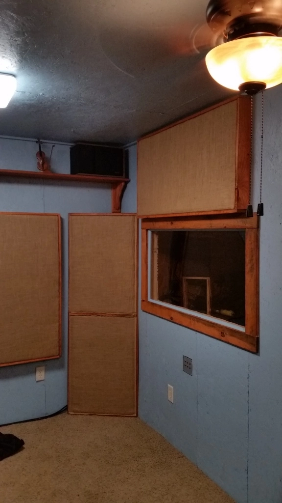

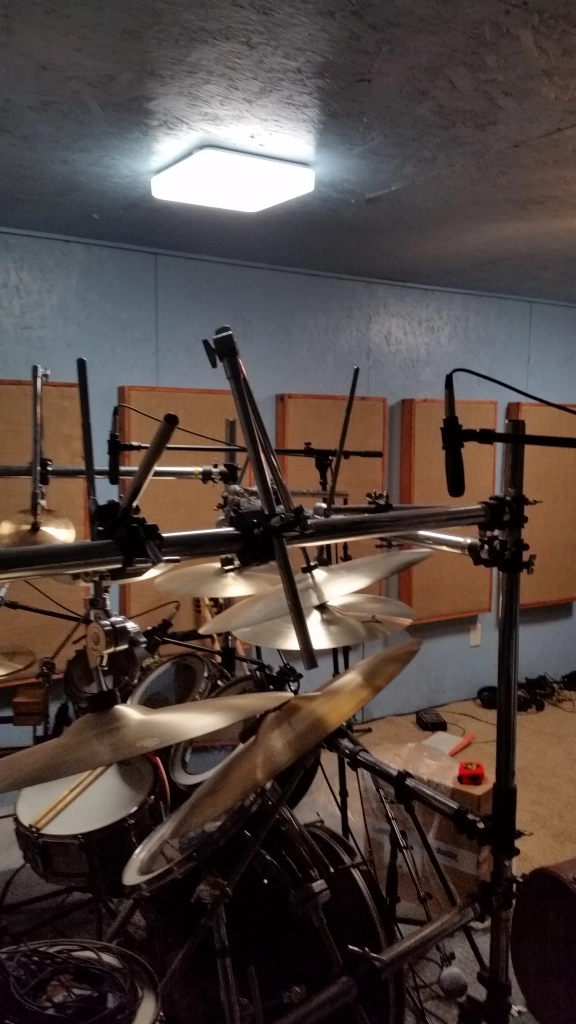

here is another link for making your own panels, I used 1x4s I got at a local lumber yard, I made mine 24x48 inches. I also bought a pneumatic stapler and cordless electric scissors which was a big help. I made a total of 30 panels. I used 2 inches of rockwool for the wall and ceiling panels and 4 inch for the corner traps. I found a 48 inch wide 100 yard long roll of burlap on Ebay for 100 bucks. I have about 30 bucks in each panel. I stapled all the frames together. with the burlap I did not use the cardboard strips as shown in the video.
https://www.youtube.com/watch?v=NSogByPUezc
here are some pics:D
