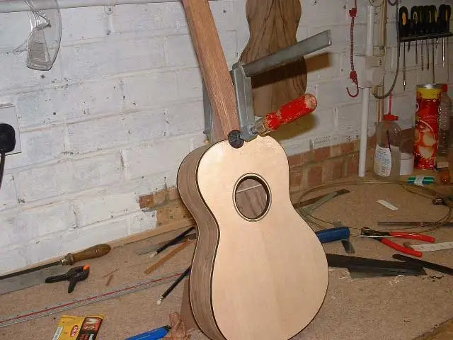

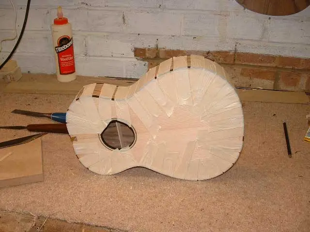

You get the idea and so know glued in place.

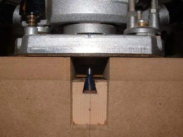

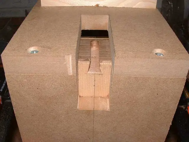

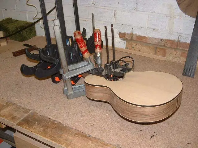

Should have mentioned I cut a dovetail in the neck block before that. Made up a simple jig as My normal setup wont do such a small body. You can just about make out the binding cut in the second picture.

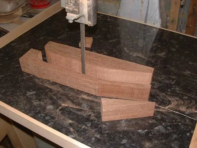

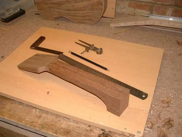

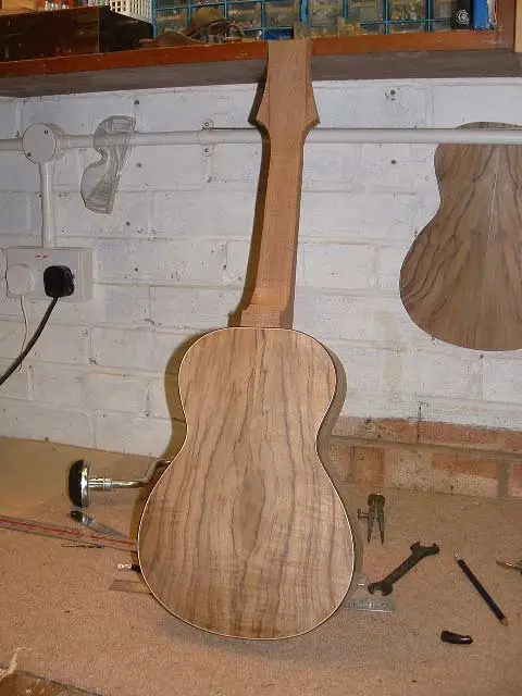

Time for a few pics of the neck. First roughing it out on the bandsaw and then clamping some wings to the headstock to give it some width. Mahogany came from and old window frame I found in a skip.:o

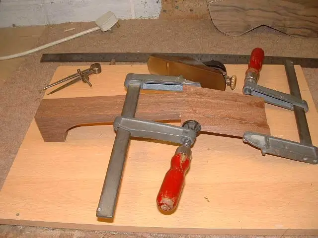

Chucked 1.5mm veneer on the face and then cut the dovetail to fit the body cut and things are beginning to take shape.

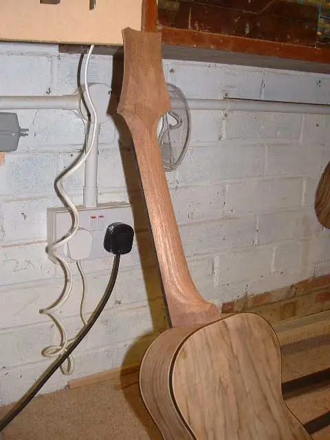

The neck needs to roughed to shape and then glued into the body.

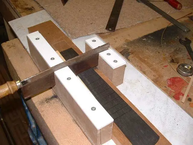

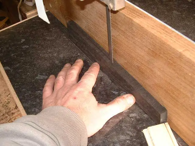

Needs fingerboard. An off cut of ebony that I can't get an archtop tailpiece from and is too short for a regular fingerboard is perfect. First rip it to thickness on the bandsaw and then cut to shape and as it is no longer square I slot it by hand on a home made mitre box as I can't use my table saw to slot a tapered board.

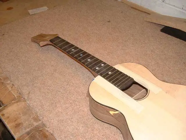

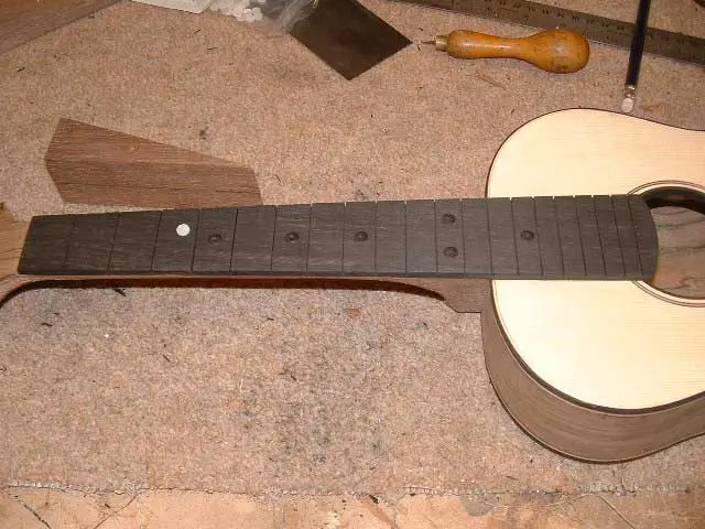

Dots would be nice, yes MOP dots. Marked up the position and drilled them on the pillar drill exactly to match the dots and wacked them in with some titebond. Chucked in some frets too and added some side dots.

Had about 2 hour left at this stage so abandoned all hope and camera as the batteries died on me stuck on a bridge and drilled out for the tuners. and spent the last hour cleaning up and added a few coats of tru oil. Left it over night and strung her up the next morning. Sounded sweet and didn't collapse.
When time permits I shall strip her back and finish it properly.
To finish, It was a lot of fun to do. A bit rushed but a nice functional instrument.
The only parts that weren't scavenged from the scrap bin or useless for anything else were the tuners strings and frets. Even the nut and saddle came from a rough bone I experimented with bleaching way back. The neck from and old window. The spruce for the linings and braces cane from an old Ikea sofa that fell apart on me. The only half cheats were the back and top which came from cleaning cuts on decent timber but that was deemed to be OK.:)
