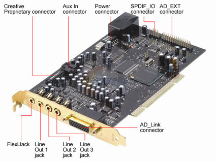

This image (from Newegg) shows 3 "line outs"- I'm guessing those are stereo line outs, so yeah- the cable Cancers posted above ought to work.

Jeff - that diagram form Newegg is probably not right - the manufacturer specs say there are two line-ins .
What is the device you have in your last post? as the RCA are coded red and white, they are left and right something (in or out)
I don't think Creative has ever gotten anything right- I wouldn't be surprised if their own specs were wrong, lol. :p;):D
Aha I did not see the info on Creative's site, but in the box is an external console w/remote, so all the inputs and outputs on this are on this, which then wires up to the i/o card.
