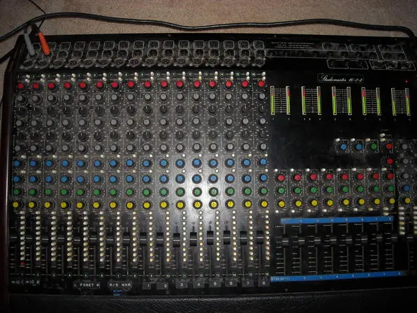

Last, but now least, for now anyway, the Studiomaster mixer. I'll post up pics of the mics, the modified JVC remote, and the Lacy Thompson compander tomorrow evening.

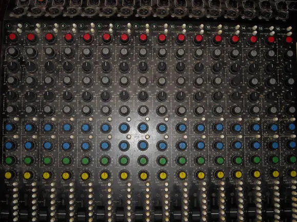

Any way you can link a hi-res copy of the control surface of the Studiomaster? I'm really curious about the control features.

I just uploaded a handful of them to my Picasa account.
http://picasaweb.google.com/jjones1700/Studiomaster1682Tascam38#
The mixer seems to be pretty similar to my M-2516. It doesn't have the MIDI capabilities, of course, that the Tascam does; nor does it have provisions for headphones.

Just another update. I ordered a new pinch roller (just in case) and a new belt for the 38 from Tascam today. I was going to order the bulbs for the meters from them but they are $9 and some change a piece!:eek: Wow. I also cleaned up the exterior of the Soundmaster mixer. I've got the TSR-8 running through it to test it out. It sounds very nice! Apparently everything is functioning, with the exception of having scratchy faders and pots. Is it safe to use De-Oxit on the mixer or is there something else better suited to the job?

For metal-to-metal contacts (switches, jacks, etc.) I use DeoxIT D5...for conductive plastic and carbon element potentiometers (yer faders and pots) use the DeoxIT FaderLube F5. Don't substitute one for the other. Not a good idea IMOmy2p.
