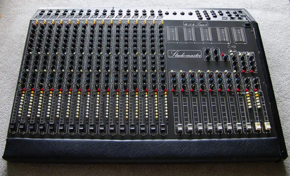

This is the best photo I could find of a 16x8x2 Studiomaster. A guy must have one and he had it posted on his Flickr account. The guy I'm buying the actual mixer from is just sending me the photos. The mixer is a little rough, but a little TLC should have it in good cosmetic order.

That...is a cool looking board! :eek:
Keep us posted!!

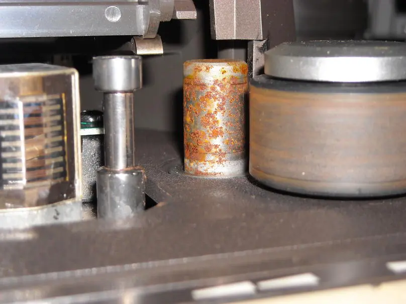

This is a pic of the 38 that he sent this morning. Still has the box! The only thing I see is that the capstan shaft looks a bit rusty, or lots of oxide. Can't tell which.

The thing to look for on the early Studiomaster boards was solder joints on the busses. If roaded for a while they tend to wiggle loose. They didn't use plug in modules, instead using buss wires going through each board and soldered to the board. To remove a board you had to remove the knobs, then the bottom sheet metal, then cut the buss wire and solder in a jumper until the module you removed is repaired and can be replaced. The one you are looking at is newer (LED meters rather than analog meters) and may be a bit easier to service.

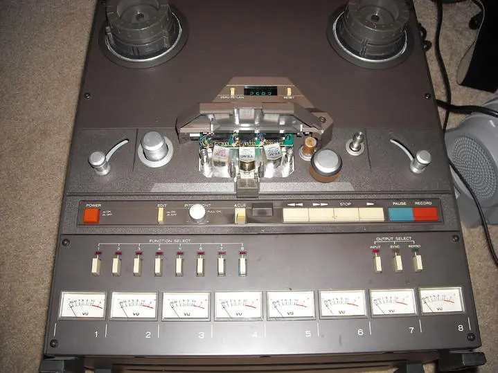

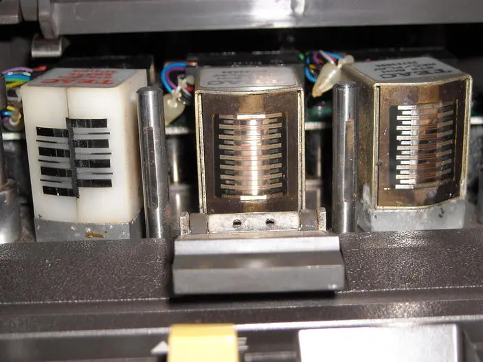

Let's see if this works. First photo is the 38 in the box with the manual and warranty card. The second shot is of the heads.

Next up, the capstan and pinch roller of the 38. Is there a way to remedy the pitted capstan? I've already cleaned the pinch roller and it is in good order.
