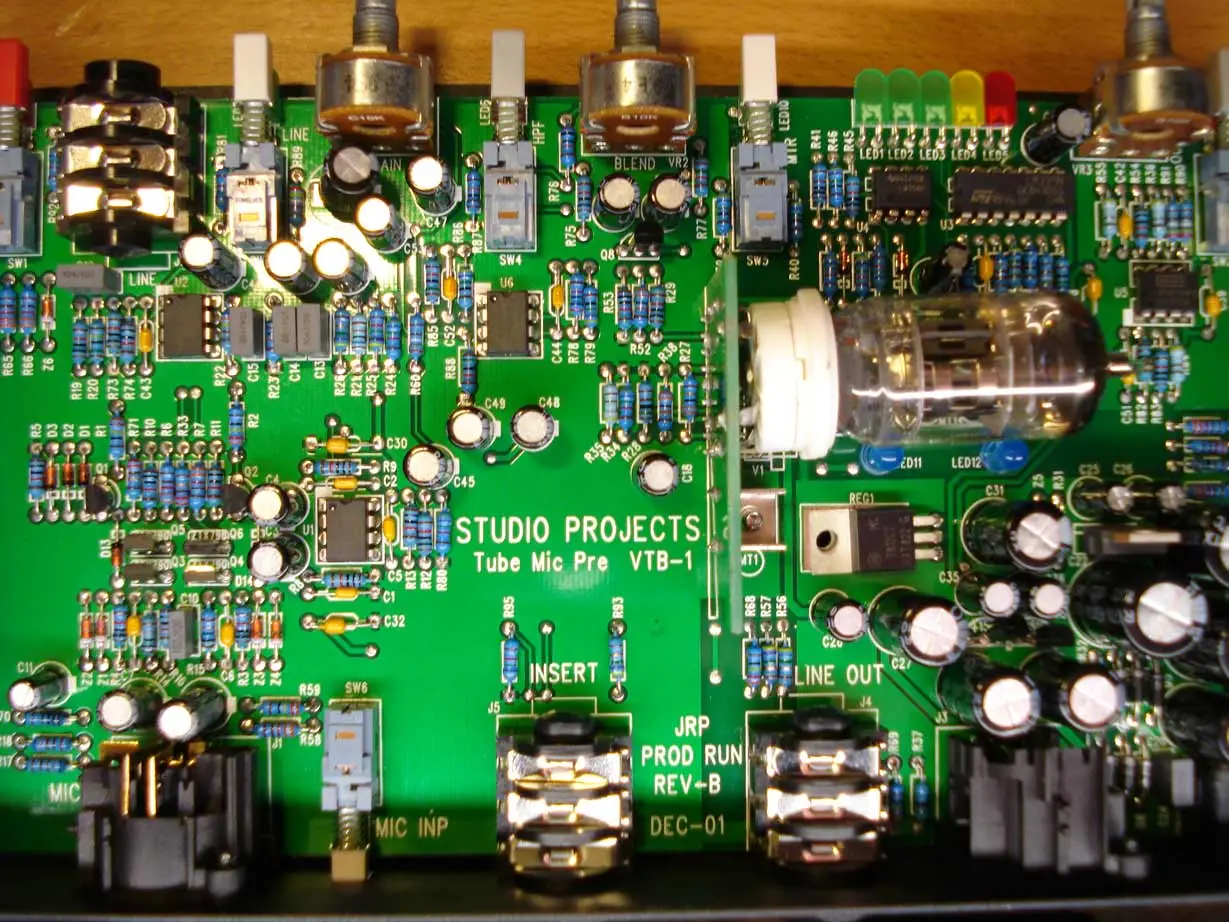

There is a 'real tube in the VTB1 as seen below. It's a 'starved plate' design that uses a lower voltage on the plates than what typically might be used in more expensive preamps, such as the UA710 which also has a blend control. While it is a starved plate design, it still does impart a tubish coloration to the sound. It's a decent little preamp and I still use mine occasionally.
Studio Projects is still alive and kicking Mic Preamps by Studio Projects . I also have two of their mics, an SP C1 and a CS5.

From the pic I posted of the innards, the pots are likely either carbon or plastic film. While a quick shot of regular contact cleaner may clean them up, I've been using DeoxIT FaderLube on faders and pots. Not sure how different the fader lube is, but I just feel better using something that may be more suited for this type of job.
As CoolCat noted, give it a try sweeping the pots back and forth and see if they clean up that way first. I think my VTB-1 had the same issue on the input gain pot also and I got away with not hitting with cleaner by just working it back and forth.
