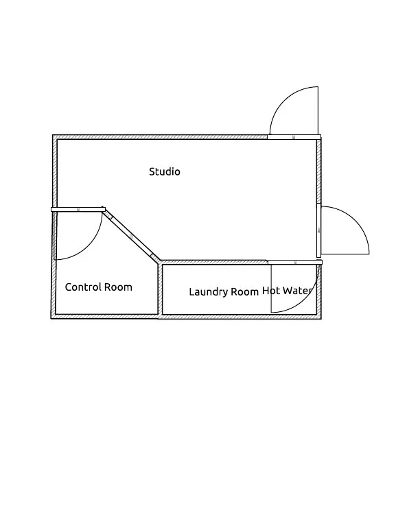

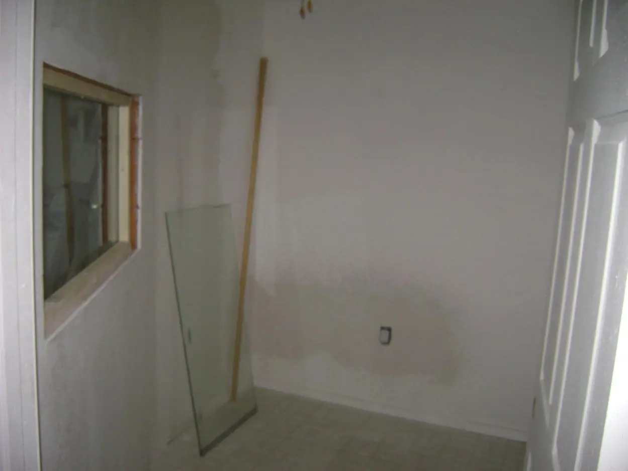

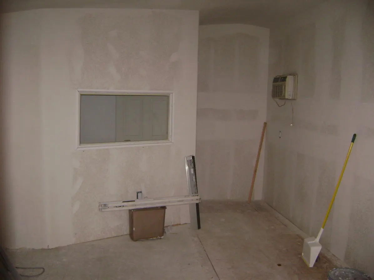

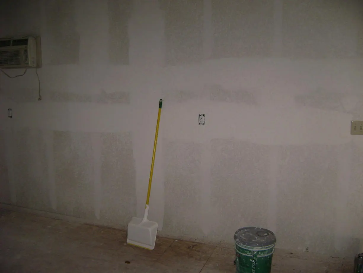

I was recently voted by the members of the band I'm in, to be their sound engineer, the lead guitarist has just had an empty studio built (currently requires sound proofing and decor), in the space that backs onto his garage, these images are of the floor plan and photos of what it currently looks like.
The control room will be using (among other equipment) the Behringer SX244FX Eurodesk mixing board, along with the Roland VS880 digital workstation, and KRK powered monitors.
The control room and studio's power outlets are all using separately breaker-ed (meaning, each GFI has its own breaker in the breaker box in the garage) GFI's, and are situation about 4' above the floor.
The studio area will be using wall mounted TRS and XLR sockets (XLR for balanced cabinet and vocal mics, and TRS for headphones with wall hooks), the sockets will be placed at various points around the studio so that musicians can reach for headphones and get ready for recording, if any of the mics break down the mic(s) can just be unplugged from the wall mount.
My dilemma is, what is the best way to route all the mains power, and audio cables around the studio and into the control room, in such a way that if there's a problem with any of the cables, they can be easily accessed?

That drawing is fairly useless without dimensions.
Unfortunately, I'm not a professional architect that can translate actual measurements to blue print dimensions, I can only use what I have at my disposal, I used a basic CAD program to draw out the walls and doors for the floor plan.
There is a glass window between the CR and studio using a double glass panel, with an air gap between the glass panels, and sealed with silicon.

I wouldn't count on mixing in that control room either. It's way too small of a space for reliable results.
Yeah...that's going to be one cramped control room...plus, you're straddling a corner in the back of it. :(
I know it's all done...but you may want to take pause and then just bite the bullet and correct it NOW rather than wait until it's all full of gear and what not.
I'm not a professional architect, either. And excuse me for sounding rude, but it's not hard to do some measurements on a drawing...particularly if you're using a CAD program (even a basic one). Are you telling me that your drawing is not to scale?
