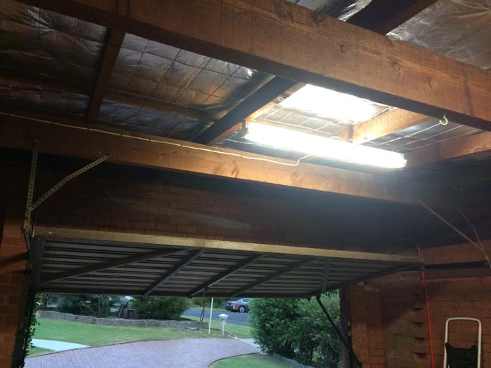

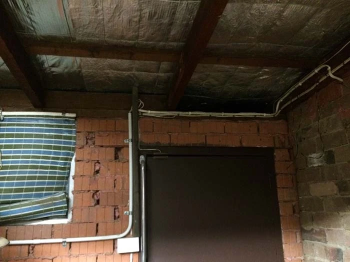

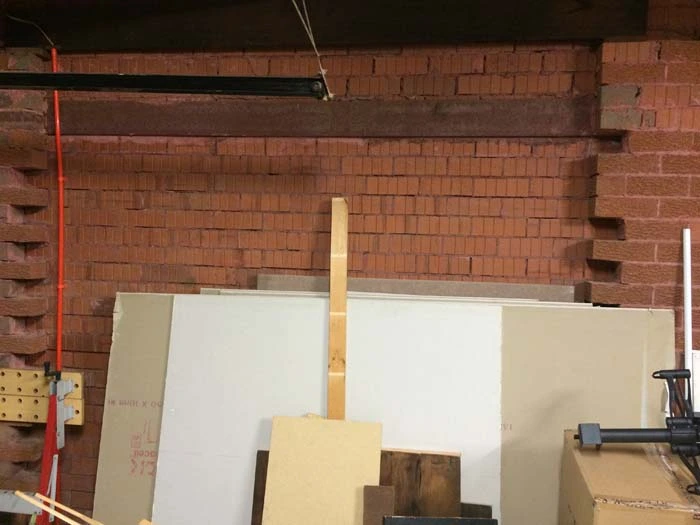

Hi all. I am making an open plan room out of the double garage attached to my house. I have attached a picture of the wall which adjoins the lounge. I'm guessing I need to fill all the gaps and then move on to framing. However, there is no ceiling - should I do the walls or the ceiling first? For the ceiling I think I will need metal channel. But for the walls (which have no joists) I am hoping to attempt to put the sheeting up in a minimal, but floating way. Haven't figured out what I can do there but putting up metal framing sounds expensive. Has anyone else started with a brick wall? Thanks.

Really need a better set of pics. I don't quite understand what you are saying about the ceiling? Better pic of the ceiling and where it meets the walls?
The question about the brick wall, I built a studio years ago where we had a single brick wall, what I did was to build a stud wall in front of the brick, only fixed to the brick by light weight steel brackets (just for extra support) I made the wall out of particle board 18mm thick and then a layer of plasterboard (the sound resistive type) the void was filled with fibreglass sheets fitted up to the particle board and an air gap between the fibreglass and brick. This wall was very soundproof. However if the ceiling does not have good construction you are wasting your time.
Doors & window information?
Alan.
Alan.

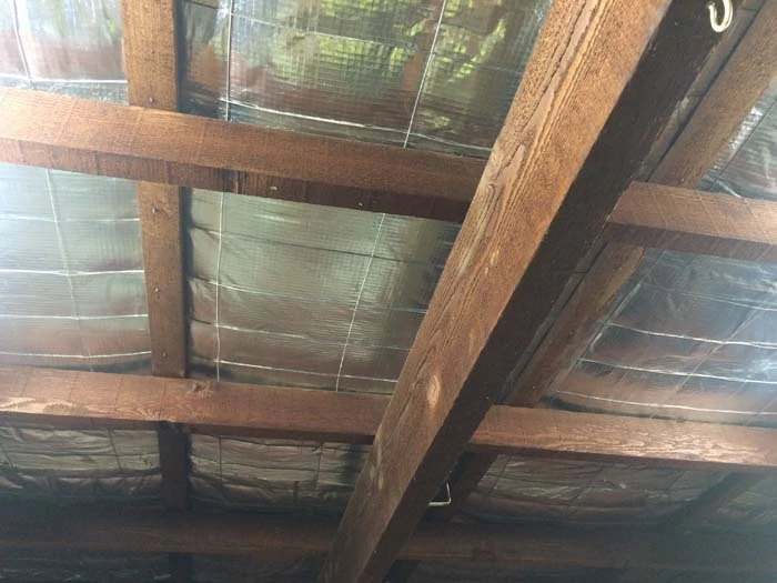

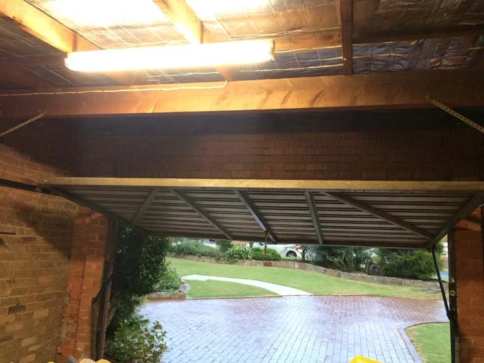

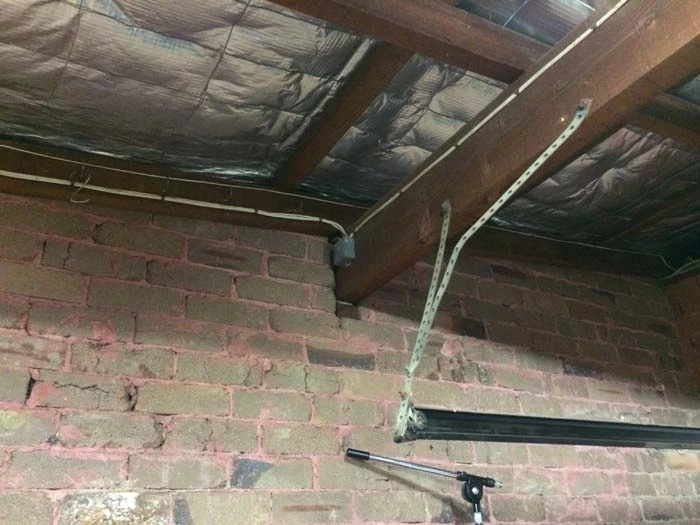

Thanks a lot Alan. I am starting from scratch. I have done this before but had help with the stud and track. I do want the ceiling to be as good as possible. There's only one window and I am fine with losing it; or if it's possible, putting a sheet of double glass in I suppose. The back door is just a door. The front door is a Tilt-a-Door and I had planned on sealing it off with plastic/expanding foam/wall with insulation. In the 3rd picture, you can see how the ceiling meets the wall - there's only a joist at the top of the wall - nothing at the floor, which is bare concrete. The main areas of sound leakage at the moment are the doors, windows and ceiling but it's a pretty solid building.

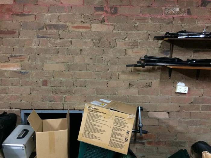

The amount of sound proofing is exponential to the amount of dollars you spend. In other words how soundproof you want to make it means more dollars spent. If the garage is away from other buildings by a distance and there is not a lot of noise around you that would ruin a recording a small bit of sound leakage is manageable, and this will cost less to achieve.
It looks from the photos that part of the wall is double brick, like pillars, if this is the case you will probably get away with filling the single brick parts with the stud wall like I suggested before, where there is single brick you need the stud wall etc.
The garage door will need to be fixed closed, remove the runners that the door goes into above your head. Seal around the door so there is no gaps. Get a couple of layers of high density fibreglass and pack against the door, build a stud wall in front of the fibreglass across the whole garage.
The ceiling may need extra supports between the purlins (the longitudinal beams) to fix the ceiling panels, I would leave the big beams exposed as this will give you more ceiling height overall. You will need a couple of layers of fibreglass on top of the ceiling and the ceiling will need to seal up to the exposed beams. The ceiling will need to be double layer sound block plaster, or you could put up a layer of particle board and then a layer of plaster like I suggested for the walls.
Window, If you want light build a double framed double gassed window, if not block it in with fibreglass and panel like the walls.
Door, You want a solid core door, if you can fit a double door onto the frame thats great, or fix sound extra thickness to the door as a minimum, the door will need a very good sealing system.
An acoustics guy once said to me that if water can get in and out sound will get in and out, everything must have no gaps.
Have you thought about how you are getting air in and out? Air-con?
If you need better sound proofing than this, you will need to build a fully floating room, and the dollars climb quickly, for a home studio this should be OK and any sound leakage should be minimal. With structure you may need to get a builder involved as there may need to be some extra support to take the weight of the ceiling.
Cheers
Alan.

It's attached to the house, but this is not a huge problem. Yes I guess I will have to settle for this. There are aircraft overhead in the mornings especially, but I'm resigned to stopping for those.
That is the wall facing the street. Originally (I am told) that was the double entrance for the cars. This was swapped to the end so they are indeed pillars. An engineer friend said (like you) fill in the thinner parts, the pillars might sound good left.
I was thinking of making a wall out of wood pallets, stuffed with insulation I'm not sure if this crazy or not.
You are the first person who knew the name of those beams! Yes I agree, I was going to do just that. Will I really need double Gyprock? I was going for 16mm fire proof. Two layers of that will be pretty heavy - so they would be fixed to studs, attached to the joists (is that the name for the 2nd layer of wood? - if the purlins are 1, then the joists, then the battens?) The ceiling looks daunting. I was thinking of trying to lightly fix the walls somehow - but you think the whole room will need metal framing?

I fixed the ceiling direct to the purlins, my building has pressed steel purlins as there is a floor above (mine think goodness) and the steel does not transmit that much. There are some isolation channels available for fixing but in you case I think you could fix direct.
I fixed the steel wall frames only to the floor and roof purlins in the current building, the previous building I did put steel straps between the stud wall and the brick but in this case it was not needed. I fixed to the concrete floor with dynabolts, 6mm, as they only need to take side load not the wall weight. I put some neoprene stripping under the frame to help with any gaps. I teck screwed the top frame to the purlins, but you would need wood screws.
I did use a rivet gun to assemble the actual frames, this is mainly to hold it together while putting up, because when you fix the sheets they actually hold the frames together as well.
I'd love to do that - in this case fix directly to the cross beams but I thought that was a huge no-no? There's nothing but roof up there I thought the ceiling had to be sort of suspended . . .
If there were people living above I would say yes, but I don't think you need worry.
Alan.
