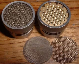

Here is what I was hesitant to do for many weeks, but finally it is here. It made tremendous change in the sound--no mudd, everything opened up. I would not say this mic is dark anymore, but very well balanced, nice sound. Next, here I will try my schematics I made for ECM8000.

Cool! I wonder if you could put the big mesh back on and leave the fine stuff off? Was it hard to remove without messing up the diaphragm?
<Cool! I wonder if you could put the big mesh back on and leave the fine stuff off? Was it hard to remove without messing up the diaphragm?>
Actually, it is hard to mess the diaphragm when you remove it... unless you are 'talented'. :D
But why do you want to put it back? The perforated thing in front of diaphragm works as a perfect screen--no noise.
Anyway, just for you I tryed it--yeah, no problem to put it on.
