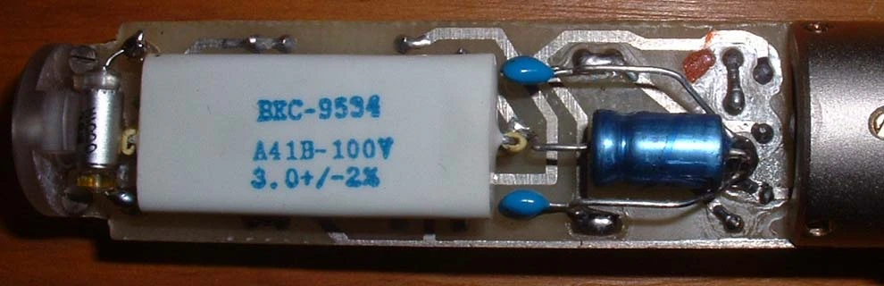

Hey Flatpicker,
Today somebody brought a couple Oktavas to upgrade. I run out of BGs and Wimas and went to local electronic store. Look what I found there. It's about 3mm thick. You remember I told you about BG instead of 1Mf cap? Forget it. Monday I am going there to buy the whole stock :)
PS. Yeah, please don't mind the flux on the right side--it is a stock one. :rolleyes: I haven't touched yet there. BGs on the way!

Ooooohhhh baby! A ferfect fit! How does it sound?
<How does it sound?>
It sounds..... good. More relaxed, open and transparent than electrolitics. Both, bass and top improved--everything more defined.
I was asking the guys in the store what's the part number, and who's manufacturer, but they even don't know how it got there... he, he. It is quite a funky store, I have to go fishing there. Oh yeah, I also found there some Vishay axial resistors--good stuff.
