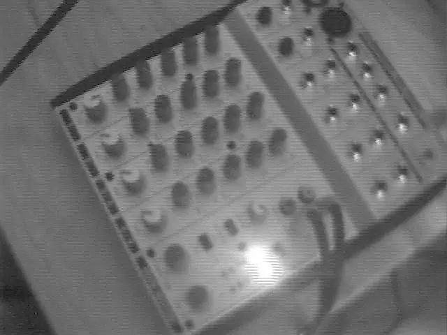

here take a look ,
Is phantom power turned on? The Rode NT1 requires phantom power. Depress the 48v button in the Main Section above the leds.
Thanks for the pic but I already pulled the manual off the Behringer site to get a better idea of what your working with.
