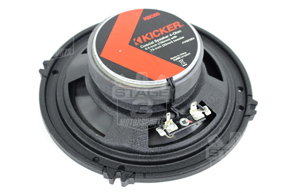

The above (if it works! I am not very computer savvy) is not a really good pic' but the best I can find quickly. See the tags? If you blow the picture up you might just see a rivet and on the left, jeeeust a wire curling under the connector board? That is one of the pigtails, very flexible braids that carry current to the voice coil.
