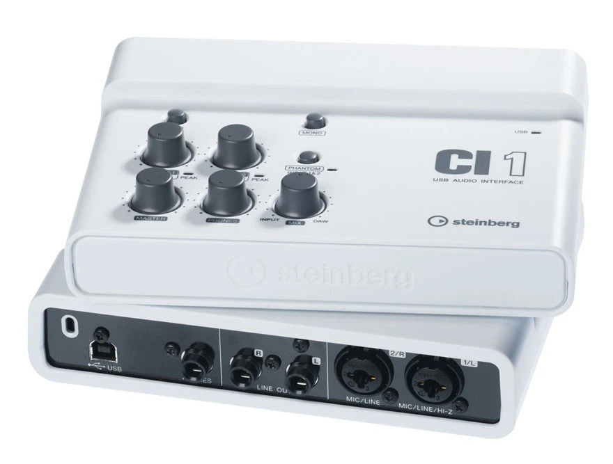

Hey yall,

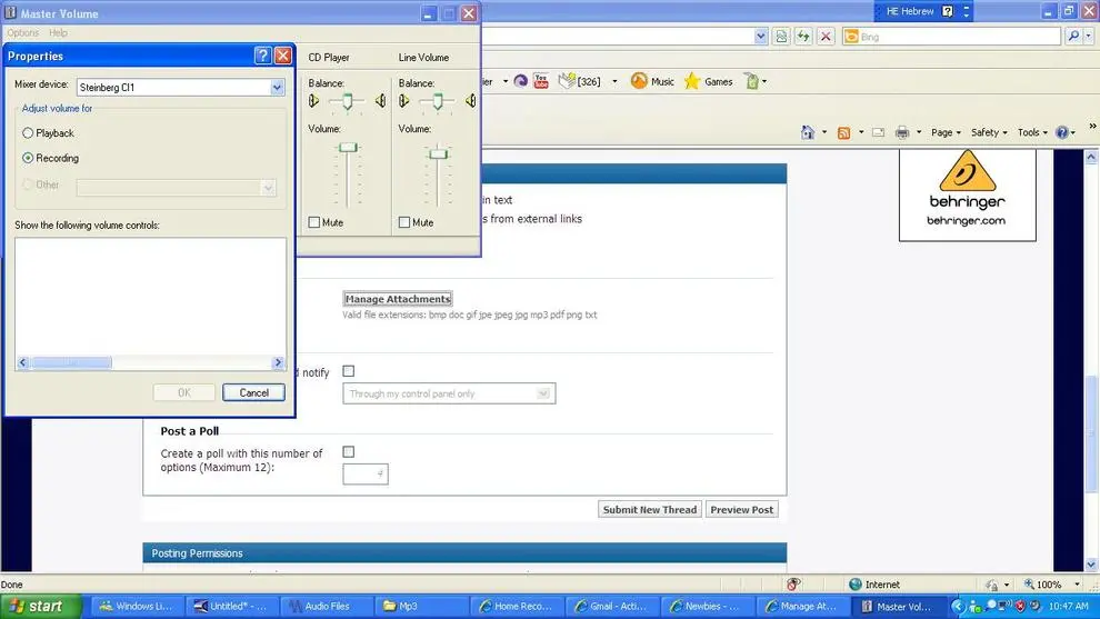

I recently bought a Cl1 Audio Interface (as it says on the box lol) and an Apex 435 Mic. I plugged the Cl1 (usb) installed the driver, plugged in the mic but I can't seem to record anything, like there is no input com. Also, when I checked the windows volume control, it shows the Stienberg category but it has no devices under the "record" catergory.
I'm using a regular PC, xp windows, I have no pre-amp (could that be the problem?).
I added two photos that will hopefuly make it easier for you guys to help me.

did you check their site to make sure you had the newest driver?
What software are you trying to record with? I assume Cubase, but we got to start somewhere. The C1 has a built in pre-amp, so that's not the problem. Your mic and the C1 are all you need. It's a setting we need to get to.You should be checking in the DAW software, not windows.
Check your setting in your I/O options within your DAW. Most interfaces won't work as you main I/O for windows, but still will work fine in the DAW.
